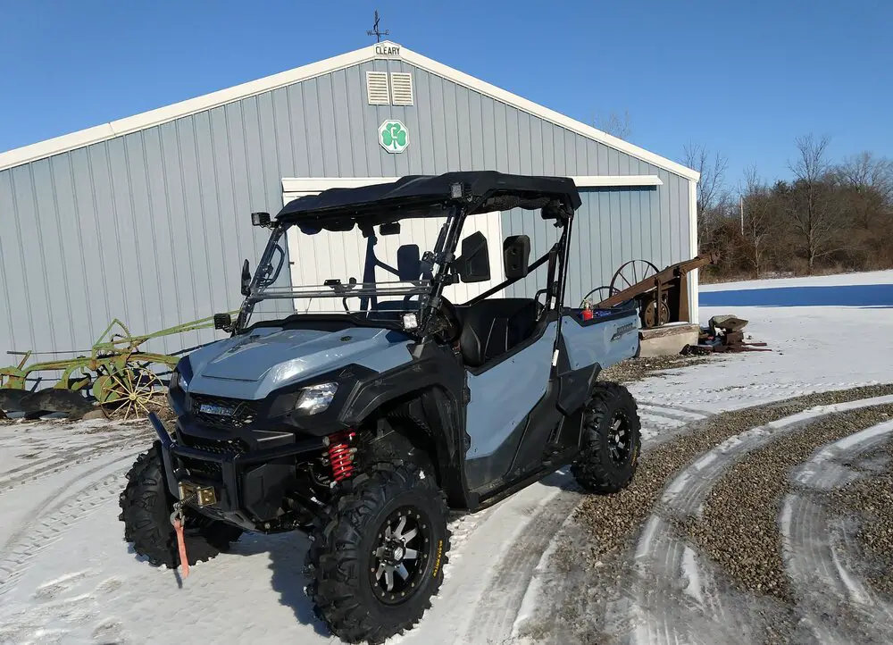

I have 28x10-14 and have been real happy with them, I do not ride much rocky areas but they do great in hard pack and mud,,,

How true to size are they?
Short but inflate them to 32psi for a week and they will stretch then deflate them to @8-10psi and they will be really close to full height.
It’s a weird regulation that tires must be measured at 32psi

The 28`` are fairly close or just under, I don't remember exactly what they measured,,, I believe the 30`` measure small,,,,

Looks awesome did u run a lift or wheel spacers?
