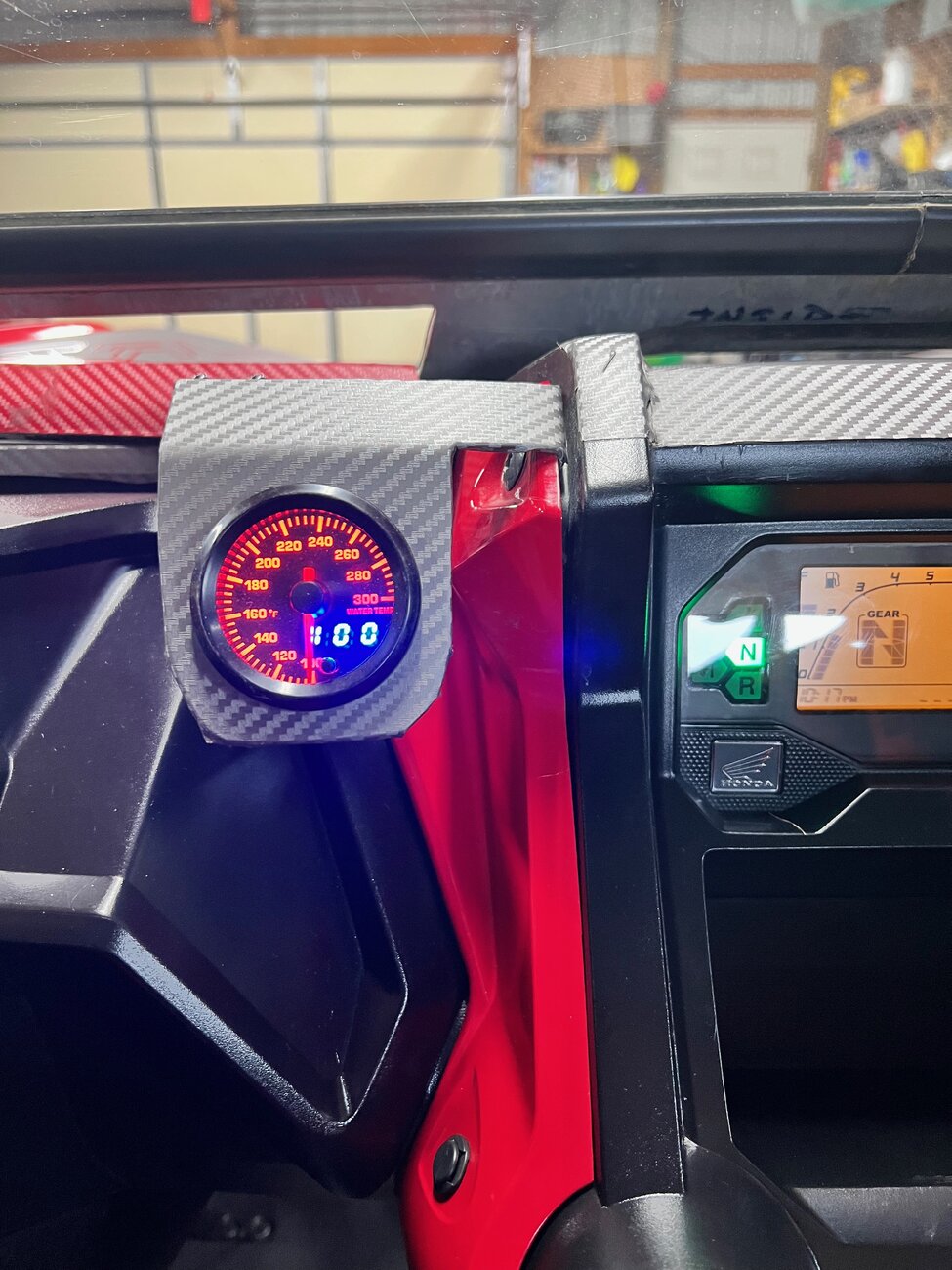

I only watch one thing when riding, actual coolant temperature.......2nd best mod after valves\springs, and no, I didn't add a second battery for the gauge.....

I only watch one thing when riding, actual coolant temperature.......2nd best mod after valves\springs, and no, I didn't add a second battery for the gauge.....View attachment 445375
Do you have any photos of how/where you added the sensor? Is it a surface contact like my Johnson outboard or actually inserted into the coolant?
IMG 2003
I put it in the fluid stream- found a (26mm) aluminum 1” inline fitting.
Never drained the coolant - siphoned some out to get below where I was cutting the hose, clamped the hose off, cut the hose, installed fitting/sensor and dumped the siphoned coolant back in and done.
