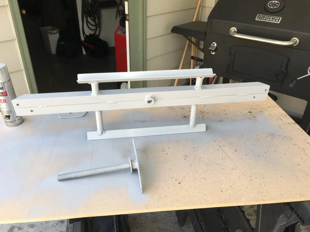

Could you please post how and what did you use to mount your spare tire. Thank you!
Pics also please

I used a piece of 2X1 channel iron between the ROP uprights. I welded a 1/2" nut in the middle and fabricated the hold down bolt from readyvrod and flat stock.

I like it, and how does that channel attatch to the ROPS?
