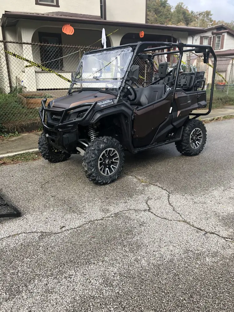

29 bighorns 2.0 on my 2016 deluxe 5.best improvement,other than Elka ft shocks.Use the search engine. Tons of threads about tires.
I run 29" Maxis Bighorns on my LE, although being an LE makes no difference as OEM clearance and offset dimensions are common to all 1000 5's.
Taller and wider than about a 29" x11 x 14 and you likely need lift and perhaps wheel spacers.
JMO, do a search.
Nice ride by the way.
I have about 6000 miles on my LE. Largest tire you can run without lift and spacers is 28x10x14 tires. Any larger they will definitely rub off road especially when turning left due to lower clearance because of footwell around brake pedal compared to passenger side.I have a 01 le I would like to go with 30 inch tires no lift but I’m thinking I’ll be limited to 28s dose anyone know how much I can do View attachment 234107
