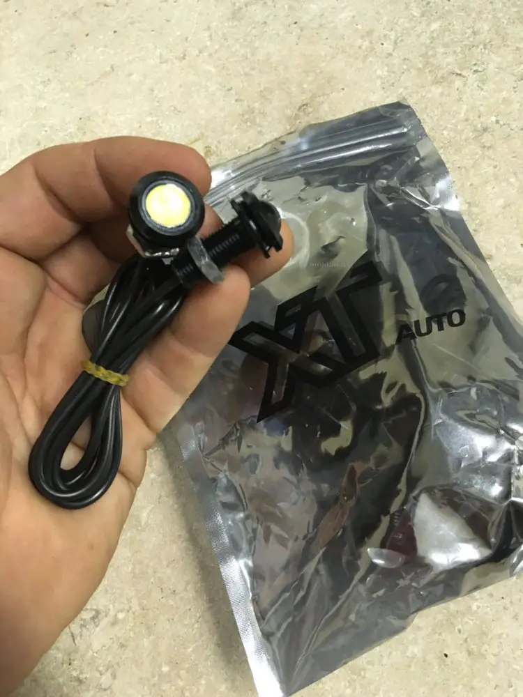

These were Aluminum alloy and 9W

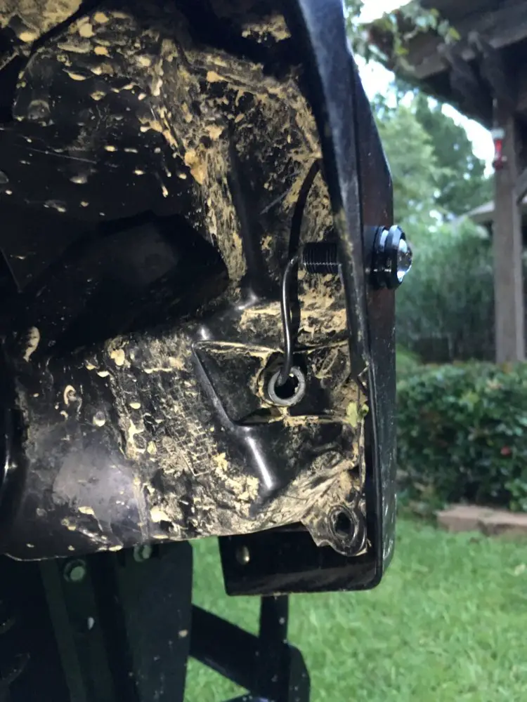

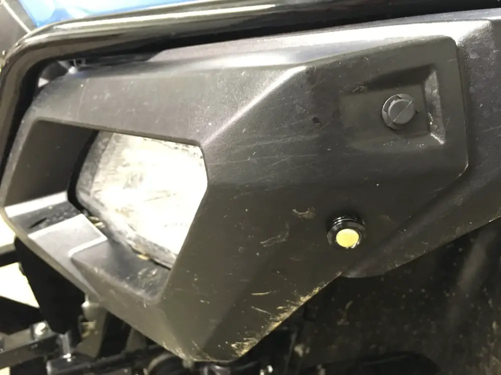

As promised.
Image Image Image Image Image
Honestly, I didn't resize the rivet hole... At 1/16th difference, I just screwed the LED through. It pulled down nicely. Metal vs Plastic, metal wins.
Also worth noting, I bought a 10 pk, but chose to do only the lower rivet on each side. The upper would have been a blinding annoyance to others.
I like it. Thanks again for the tip. This is a good forum. :cool:

As promised.
View attachment 20560 View attachment 20561 View attachment 20562 View attachment 20563 View attachment 20564
Honestly, I didn't resize the rivet hole... At 1/16th difference, I just screwed it through. It pulled down nicely. Plastics vs metal, metal wins.
