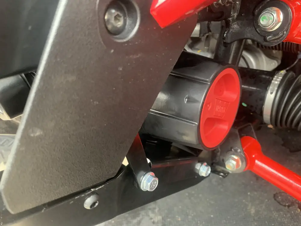

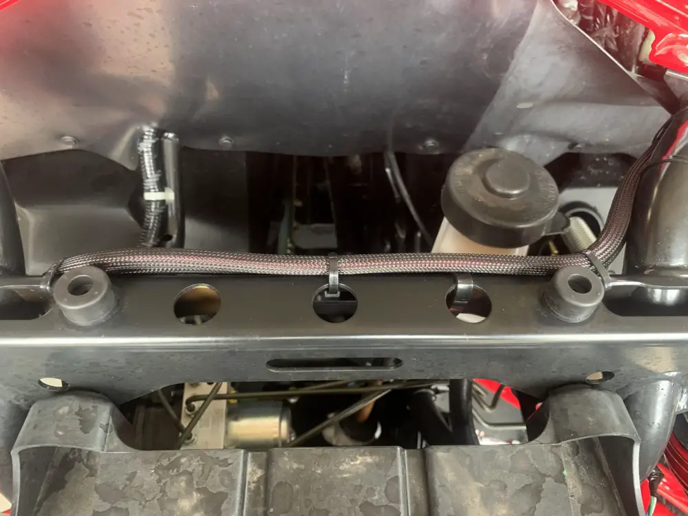

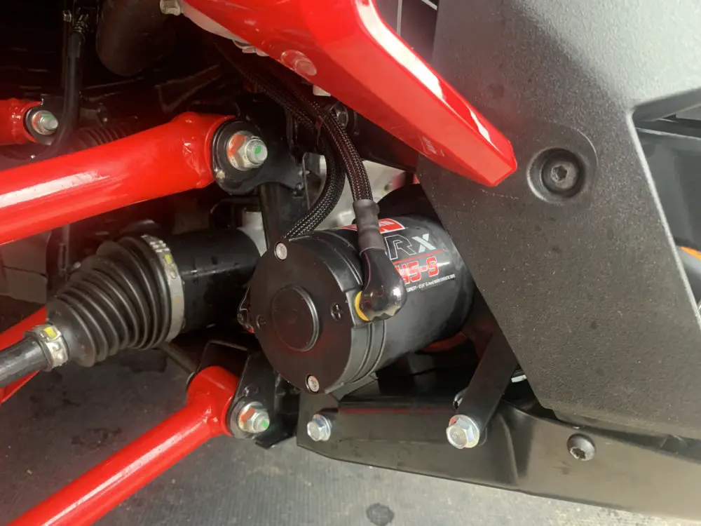

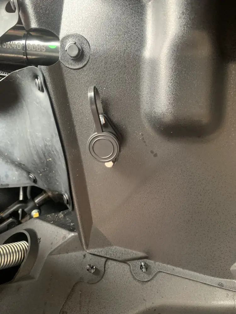

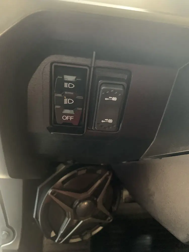

After looking at a lot of choices for winches and mounts. I chose the Warn 4500 with the synthetic cable and the Warn mount. I think the mount looks just like the Honda mount in the instructions. Installation was simple for the winch. It took a while to loom my cables but it all turned out well and tucks in nice and tight. I also used the switch adapter from this site to install my in and out switchView attachment 177193 View attachment 177194 View attachment 177195 View attachment 177197 View attachment 177198 View attachment 177199 by my head light switch. I installed the plug for the remote cable under the drivers side wheel well.

Nice work MFG. Clean wire run. What kind of split loom is that you used?
It is not a split loom, that is why it takes a while to get your wires run though it but it looks factory when finished.

very nice installation. Harry have a factory winch installed but I would like to install the rocker switch kit and I can't seem to find where to get it. Could you help?
The switch and adapter are available from this site. He has a store on the main front page of this site. The prices are great and the shipping is fast. That is where mine came from.
