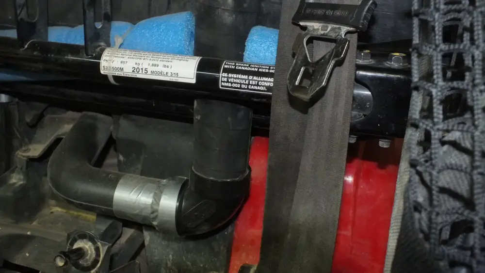

I cut mine off, then used a 90 degree ABS elbow and 18 inches of rubber pipe to bring the input up near the top of the cab. Used JB Weld to fix the elbow to the intake pipe and the rubber pipe extension. Cut the air intake pipe just a bit into the flare, just so it fits into the elbow.
I snorkeled mine with ABS.. then use a prefilter on the end of that.. Dust is the enemy of summer driving here in PEI.
