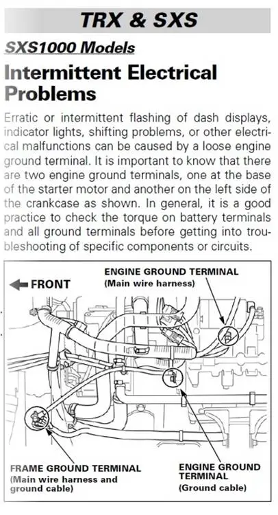

I guess I really need some help finding all potential ground contacts so I can check them. Anyone have a good thread or diagrams?

What's the best access for those grounds? From skidplate? Under the bed? I already checked under the seat, and not much is accessible there.

yep. I charged and installed a new battery. no problems anymore. But, I want to check the grounds anyway.
What's the best access? Through the rear seat floorboards?
