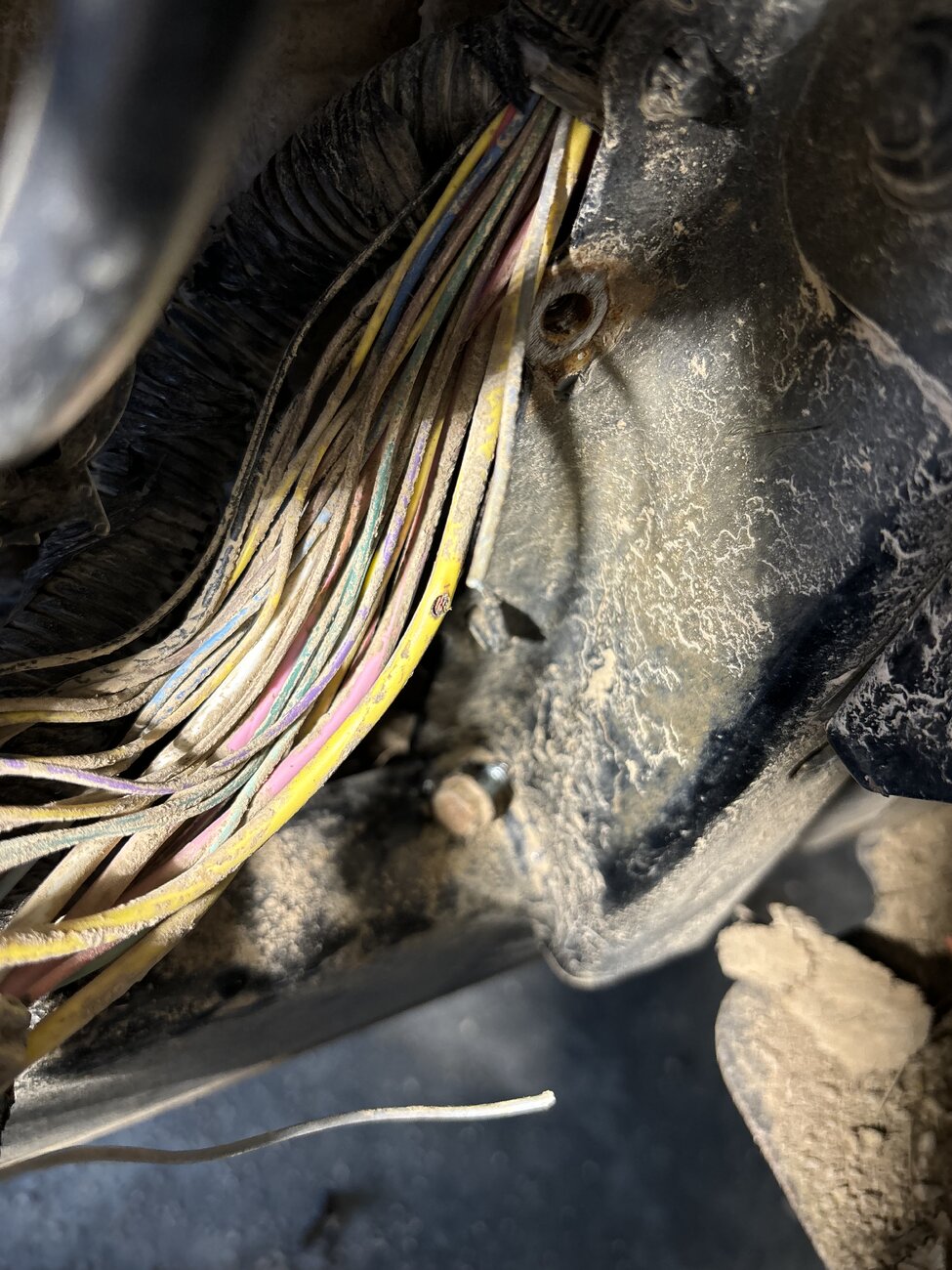

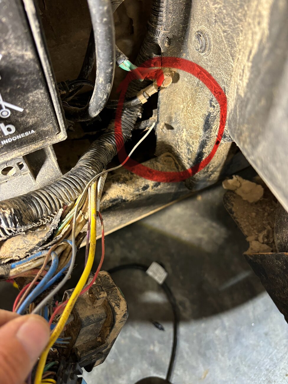

Found and fixed my fuel supply issue. I was able to locate a wiring diagram for this 2022 P520 which confirmed circuit terminations for the fuel pump and found an "open" in the gray wire (fuel relay to PCM). One other wire had a small nick in it - located about 10" from the relay inside the wire loom (20+ wires). Thanks for the earlier replies. Now on to the next one - grandsons TRX250 - carb idling issue.
View attachment 437628 View attachment 437629
