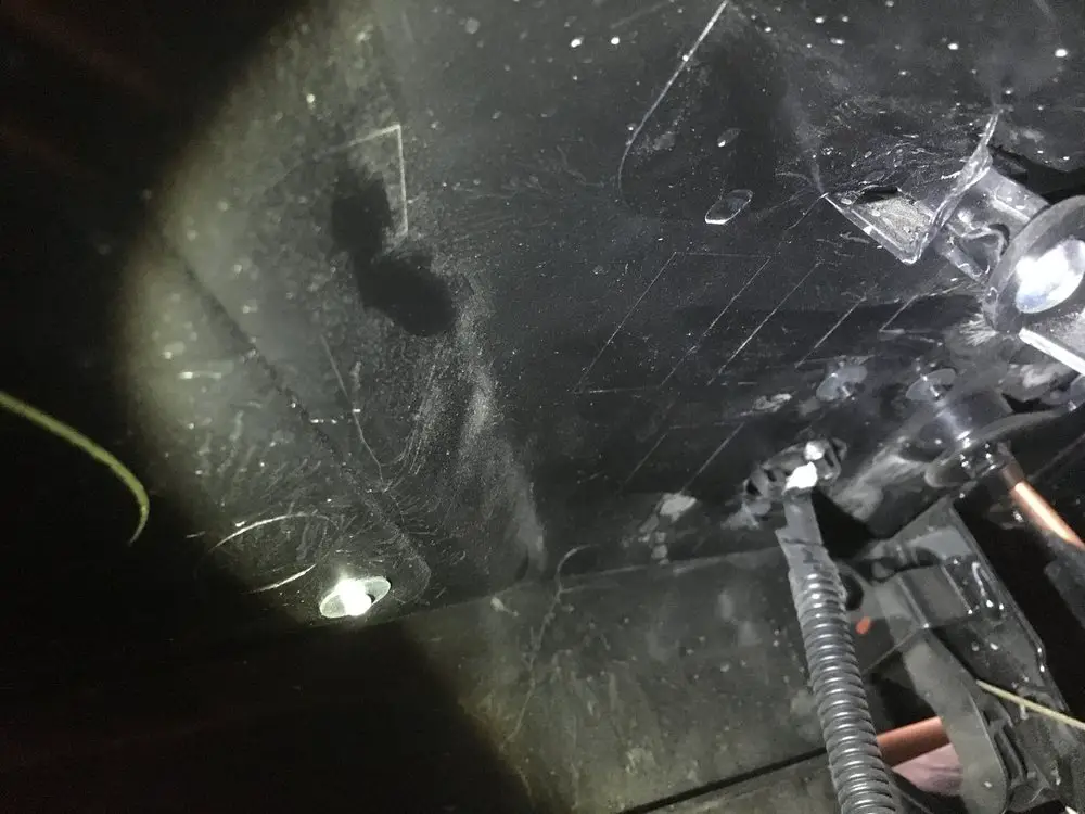

if you look up Honda accessory online for installing them they show you the cut out. us a drill about 5/8-3/4 a step bit works great then a dremel bit to finish take you time.
Was able to open cut outs with utility knife blade, just wiggle back and forth for clean square cut.
