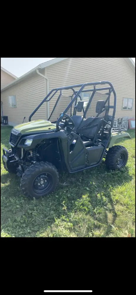

Born and raised in west Michigan, Grand Rapids area. Spend a decent amount of time in the evart area on friends hunting property. Here it is before the mods start
Nice 500s! buddy just bought same year and color. Gotta show mine off- first time half ass cleaned in a year.. bh 2.0 26 9 12’s on all 4, 5+2 quadboss coercion’s with 1in rb3’s on rear. Best, lightest setup I’ve had so far.
