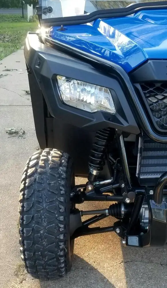

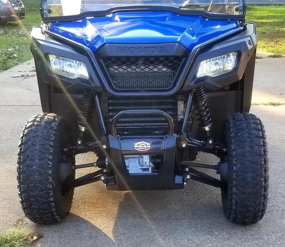

Well this new machine was out just like my new Talon was. Steering wheel off and passenger side was about 3/4”+ toed out, which made it really push on the asphalt. if you look close at the pic you can see it. With steering wheel set straight the drivers side was perfect. 10 minutes later using the string method all is good. I’m thinking the person at the factory has a bad left eye or not one at all.

Mine was significantly out of whack too. Took 2 turns of the turnbuckle on both sides to bring mine back in. Then had to center the wheel. For what they charge for these things it kind of pisses me off.
