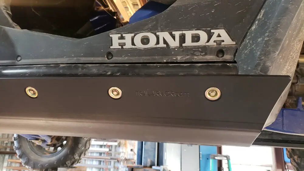

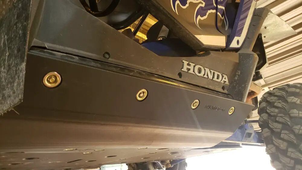

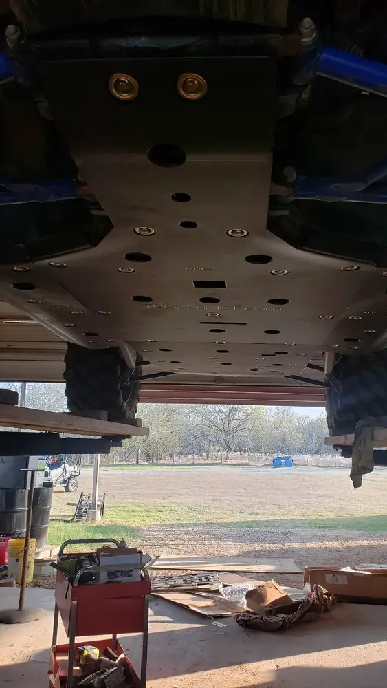

The factory plates are 1/8" plastic sheets. Not very much protection!!!!!!
I just installed the Trail Armor 1/2" skids, these also come up the sides a little to protect the side tubes and rear fenders. They do collect more debris and are more work to clean, but i feel well worth the extra work.
IMO these machines should not be taken on any rocky trails where you would strick the bottom before after market skids are added.
PM me if you have any questions.
IMO these machines should not be taken on any rocky trails where you would strick the bottom View attachment 239449View attachment 239450View attachment 239451before aftermarket skids are added.
I agree. Worth the money
