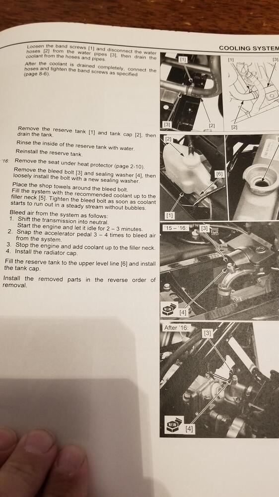

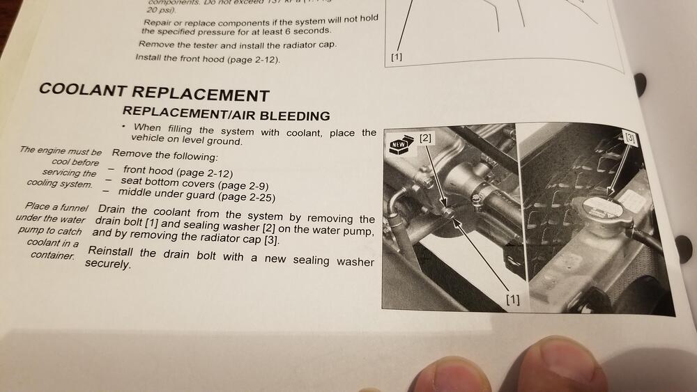

There is a drain bolt on the water pump.
Let it drain.
It also says to drain the main lower hose.
Refilling. There is a air bleed screw depending on what year you have. F9d8a49d1707b2089aa8503000f1635eAb7dc9b56c2e0472ccd9de96b1c1f606
18,456
66,881
3 US qt will fill it all. 2.4 for motor/rad
.5 for overflow.
Says 1:1 mix ratio.
Pro Honda Coolant or equivalent high quality ethylene glycol antifreeze containing silicate free corrosion inhibitors.

3 US qt will fill the motor and reserve.
Says 1:1 mix ratio.
Now , i have a start..... thanks for the manuel shop picture
