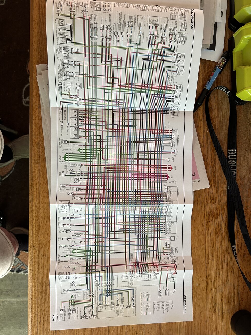

Well I isolated it as it stopped when I pulled the 10 amp fuse labeled “fuel” Maybe relay to fuel pump? Pulling the fuse seems to have reset it as its been a couple hours and it has not started making noise again.

Thays good and bad. There is obviously an issue and you may have just made it an intermittent thing. There is that possibility Being under warranty when u take it in, it wont do it. Then your gonna be up the creek with this. Hopefully you can replicate the issue or it comes back.
Either way, better buy yourself a trailer and get it to the dealer.
Did have the rig on a battery tender?
