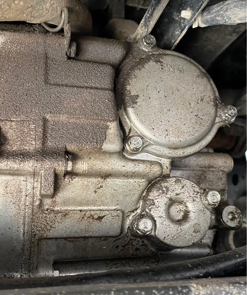

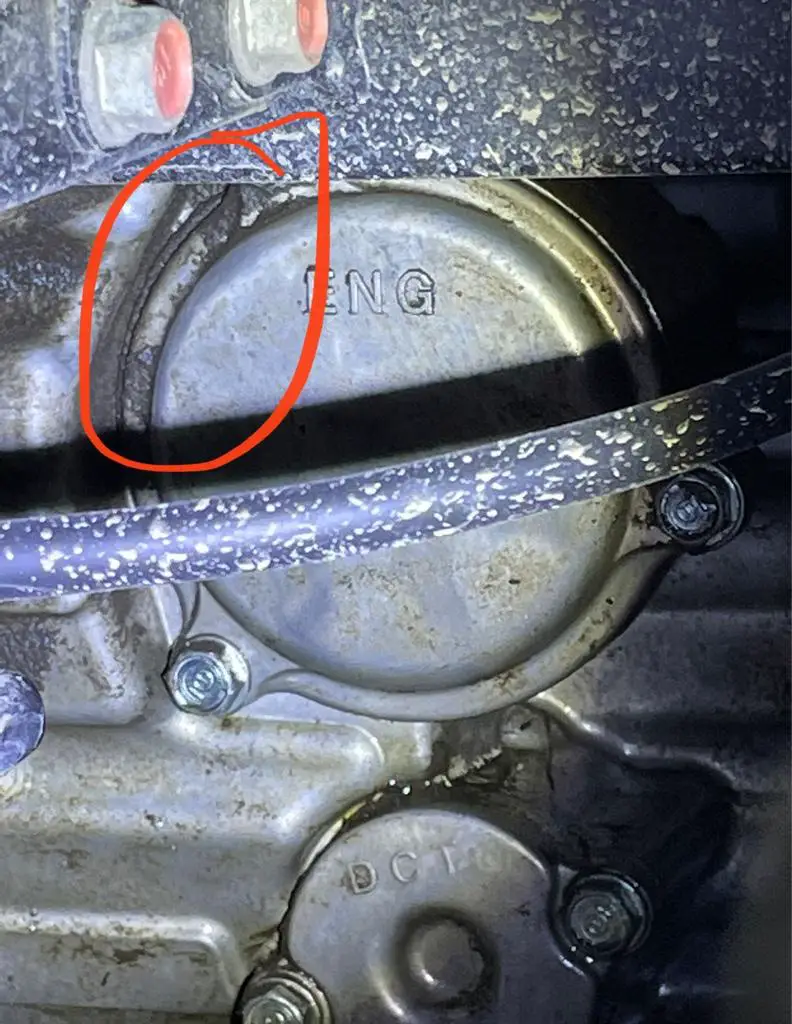

I recently noticed a few drips of oil on my garage floor coming from the SxS. I changed the oil in November and it has about 200 miles since the oil change. I've been checking the oil before each ride and oil level hasn't changed.
The engine and DCT filter covers are pretty wet so I'm thinking maybe a damaged/pinched O ring. Is there anywhere else I should check first before I buy new O rings? Af5e953d58046ebbf49112d0d7e947ba

I don’t know if you have access on a Pioneer (Talon is easy) but the machined edge where the o-ring has to get past is quite sharp, I intend to ease that sharp corner so the o-ring can slip into place easier. Don’t go too far, the o-ring is pretty close to the edge of the filter cover so we don’t have a lot to work with.

Check the dipstick o ring. The leak may be above them and seeping down.

Hopefully it’s just the O ring that’s a cheap fix then you can use the same filters but you will have to top your oil off just don’t over tighten the filter cover I have read that some people have broke the bolt head off like the other guy said check your dip sticks also
And - it’s fairly easy to get the dipstick in wrong - there’s something at the bottom of the dipstick hole that catches the tip of the dipstick and tilts it a few degrees. Make sure the tip is forward of that obstruction and the stick is straight in.
If you have slid plates, we tend to make a mess on them at times when we change the oil so u
Could quite possibly have oil spraying from that u have on the skid. Reason I say this is that u said you have no change in the oil level since this has happened 🤔
Before u go and change the oil again to do that hasket, get the oil residue off the engine, clean it good and the skid. Drive it then check again. Do easy stuff first, check them off the list. Work smarter not harder.

Checked the dipstick and O ring is good and no oil around the outside.
I thought about the skid plate having oil on it but I’ve driven over 200 miles since then. Half of those miles in Colorado through some deep snow so I thought all of it would’ve washed out by now. I might drop the skid plate and clean everything just to confirm.
