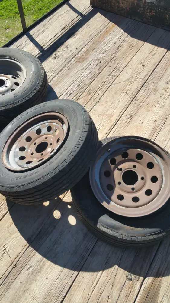

Dang bud! 2 trailer flats in one trip?? Somebody upstairs was mad at you! Lol
Good thing I have my tractor on the trailer, I used it as a jack on the second flat. Used a curb in a parking lot for the first on.
I'm just glad it happened before we left for Tennessee
P.S. I had a right front tire on my tow rig seperate yesterday too! $1700 for truck tires and $200 worth of trailer tires all in one day.
