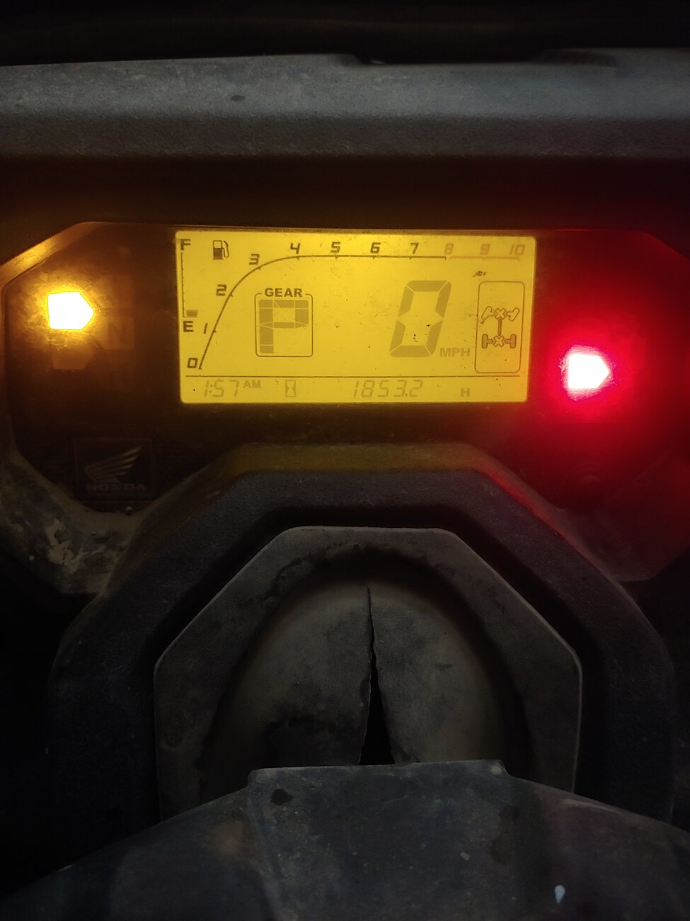

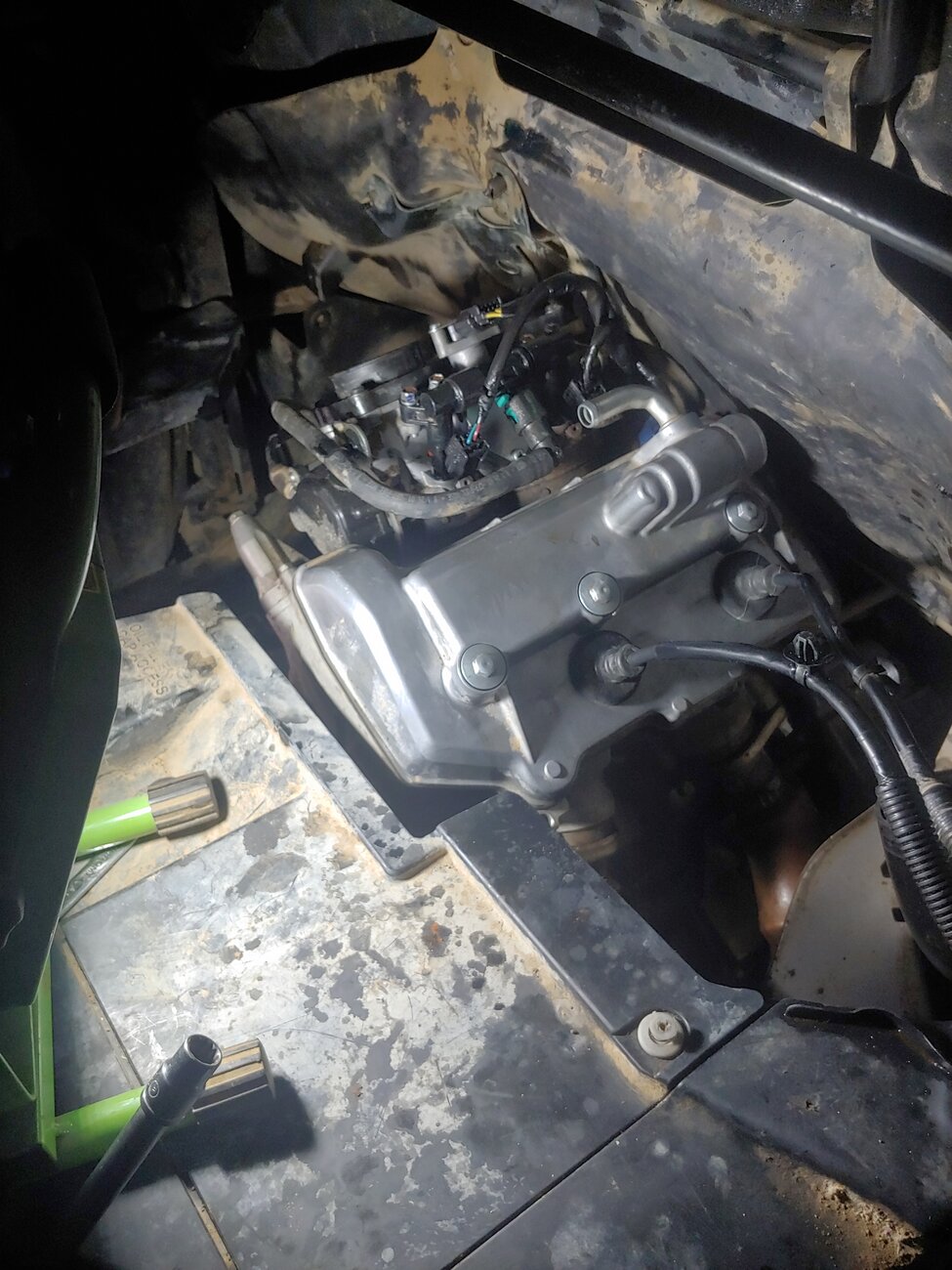

Has anyone figured out this problem yet? I'm working on a 2018 1000-3 18,000 miles, that has a dead miss on the front cylinder. Its rich, not lean. I had a bad coil and replaced them both just because, new plugs, ran great for a little while then started sputtering just before it shifts, shifts ran good till the next shift. I found the front cylinder front exhaust valve was very tight, adjusted them all to .009, no change. Checked the injectors, nice spray from both, swapped them, no change, front cylinder still dead. I don't have a compression gauge to fit it yet, so no numbers for that, but the compression feels pretty even in both cylinders. Sorry for the epistle here, but I'm pretty stumped. Any help would be very appreciated. Thank you all for your time.

Your injector wires may be bad, if they are the Club Store here has the fix. Pictures or it didn't happen.

0125231943 HDR
