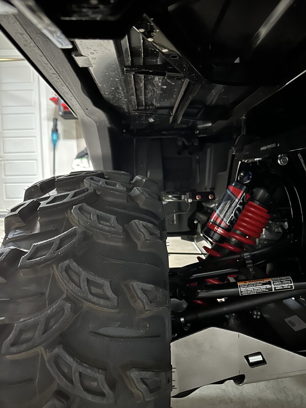

Got the 1000-5 fox shocks in as well as the 300lb single rate springs from Dave's. Pulled the stock shocks on the front and they're the same size! Has the springs swapped over and shocks installed in no time.
We are heading to Tecumseh Trails Off-road this weekend. I'll report back how the 300lb springs do. Hoping I picked the right weight, but worst case I'll jump up to 350-400lb. I'll definitely be ordering the rear shocks now too. Anyone know the cheapest place to get them? Part # 08Z71-HL4-F00.
Got some pics of this for the other P6’s?
Pics are kind of a big deal on here when we describe things. We are imagination deficient. 🤣

I will be working on putting a thread together for this, just wanted to get the ball rolling first! A proper intro will be coming along shortly as well. First priority was to get the P6 riding better so I could start sharing my journey without getting banged around!
From all my reading and research, it appears the fox shocks are all identical between the p3, p5, and p6, with the only difference being spring rates. I just snagged a left rear fox shock assembly new for $200 (P3)! Now just to find a pesky right rear assembly for a good deal!

Someone may need to correct me but I think the rear shocks side to side are the same. The reservoir just changes sides. I think either rear technically works on either side. The reservoirs just might face differently and you might find someone picky enough to notice.
If the rears are swapped, the reservoirs will smash your brake lines and damage them. I'm sure if you rode long enough that way, it would also damage the reservoirs. I had my on the wrong side and someone on here pointed it out in a picture I posted. Sure enough both brake lines were damaged and I replaced them. Probably had 2 rides on them. I got lucky.

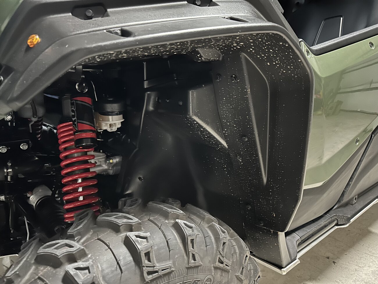

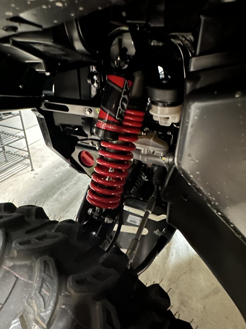

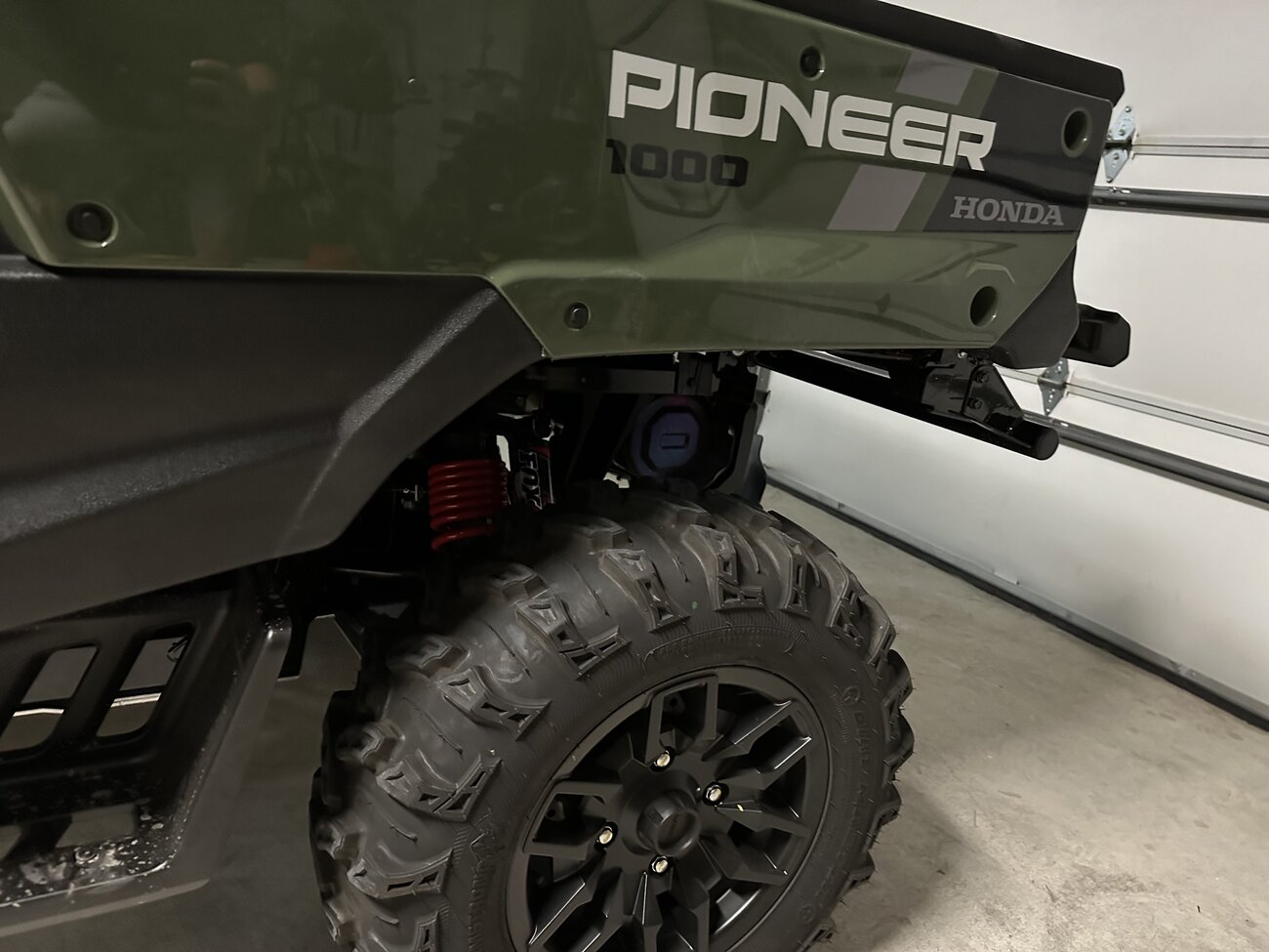

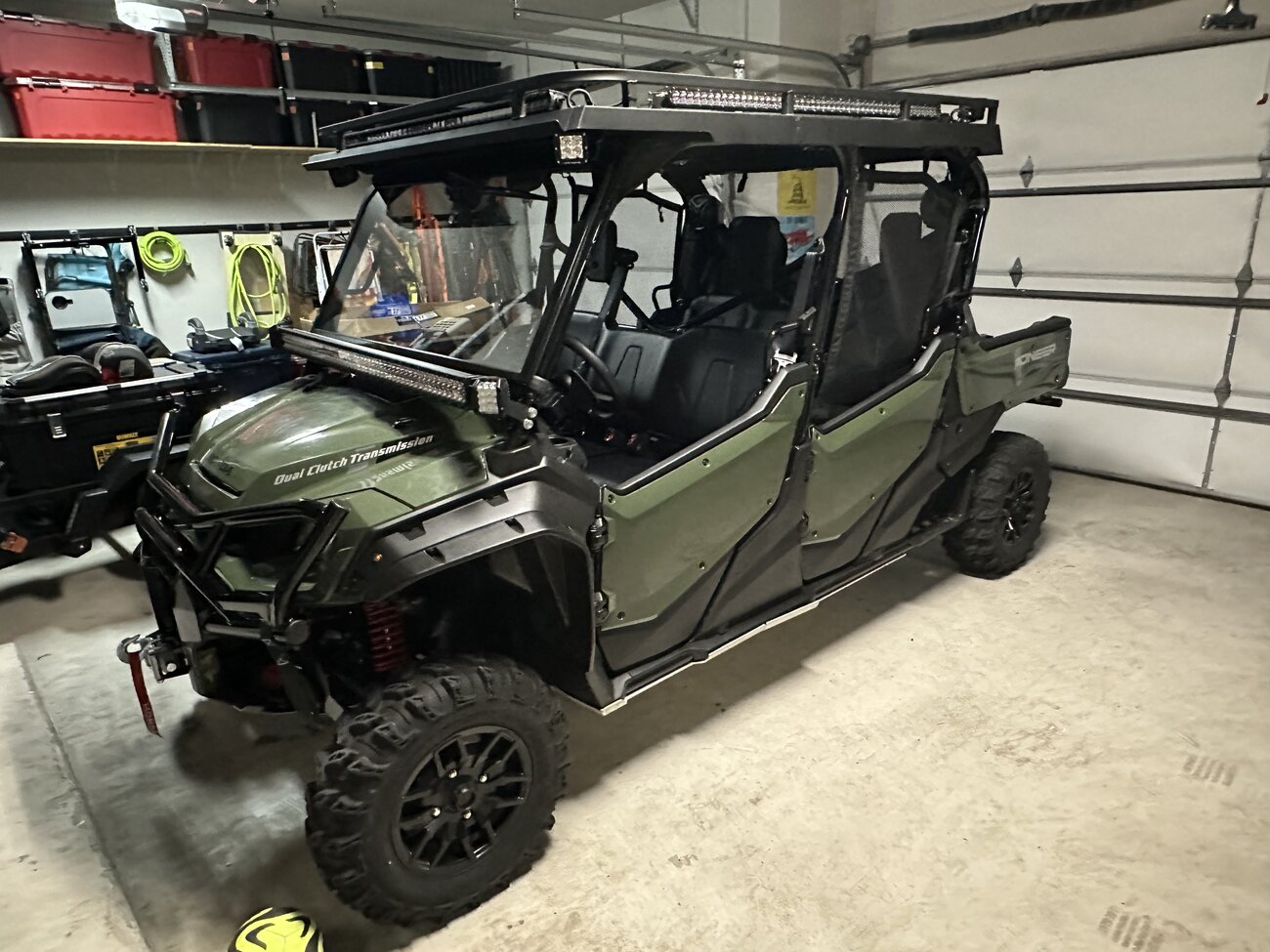

I ended up going with the Fox 2.0 Qs3. It rides like a cloud. I did confirm the it is just the stiffer spring in the rear is the main difference but for my use nothing I really need to mess with. I can swap out springs and have reached out to Shock Therapy.
I am waiting on Texas Tough Customs 6 inch long travel kit which wont be ready for almost 2 months and will share that later.
IMG 3808 IMG 3803 IMG 3805 IMG 3806 IMG 3809

View attachment 406060 View attachment 406061 View attachment 406062 View attachment 406063 View attachment 406064
Hard to tell from the pictures, but I think your rear shocks are on the wrong sides. Very important to fix it or you will damage your brake lines/a arms.
The reservoirs should be pointing towards the front of the SxS, not the rear. Just need to swap the shocks and you'll be good!
I'm getting the rears ordered for mine too!!!
