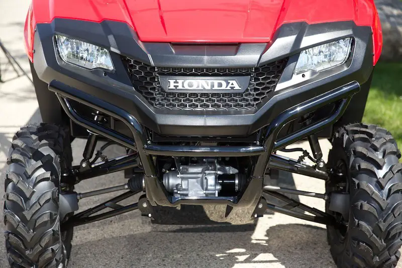

23A2500D 02A4 452E B64D BBD831664B22
much larger then the 500s

yes that's the 700
I couldn't find a pic of the 500 to show comparison

not ALOT bigger but the p5 doesn't have the( bump out) on the passenger side

View attachment 8207 much larger then the 500s
From what I can see (in the parts diagram from my previous link) this is the only difference in size where the 500 has a cover on this side of the differential. Even the part numbers match, except for that part of the case and that looks to be maybe 3-4 inches larger? I don't have one to look at also, I will have to take your word for the size difference.
