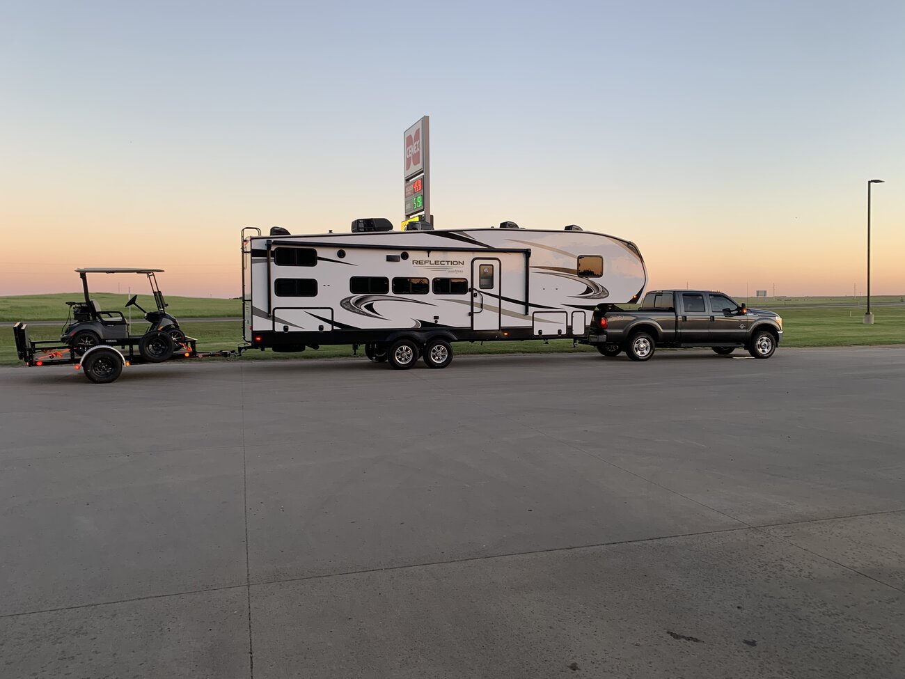

Yeah it’s essentially a sand rail trailer.
unfortunately your rig will get to experience every seam in the road and you still have the issue of lights and fenders.
the tires on the trailer will take and transfer all the shock loading to your rig. A few hard jolts and it won’t be long before you get stress cracks in the frame of the trailer or your P500.
I looked at this very hard for a long time…and it’s one of the main reasons why I sold my toyhauler this spring, will never go back to a toyhauler ever.
For the camping I do, and the places I go, it’s much easier simply pulling doubles. This way I can either drive to the trail head or trailer to it depending on location. I’m also not feeling obligated to take the TH vs trailer and hotel either.
FC0F5038 32FA 4EC2 BD3D F9F9A228F627
For your p500 I’d seriously consider loosing your canopy or topper and pickup some ramps…yes even mad ramps…vs a sand rail trailer.

Thanks for the reply. It sounds like you have strong feelings about the toy hauler. Can you give me the pro/cons?
Thanks
Thanks
In addition to what I already mentioned, Got tired of the kids and wife complaining about the bugs and heat from unloading at night or the fumes. Also got tired of never having the option to bring my boat etc. And got tired of always cleaning up the garage part.
Dispersed camping with a fiver TH is a pia as well due to the height and length.
They are crazy pin heavy and trailer like crap due to the extended height etc meaning you need a lot more truck on the hitch.
Thought they were awesome till I owned one for 3 years. They are always a compromise on something.
They have their place, and people like them…just not my family.
