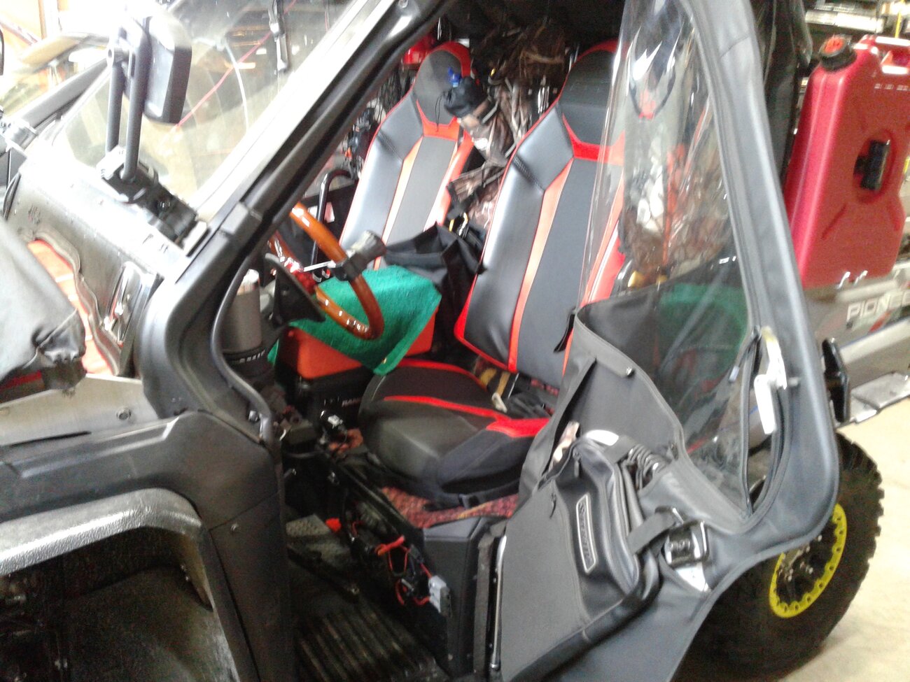

Requires Welding
Add & locate cross piece with Bent to Fit <> OEM Front Lower SEAT Mount
Add & locate piece flat plate with Hole for <> OEM Lower Rubber Bushing
Add & locate a tab with Hole ( uses OEM inner plastic under seat BOLT locates & holds seat in place )
Can lower 1in.
Cut the 1in. square Off & replace with 1/4x1in. flat stock ( then add above described )
Pictures give best description :
20220415 181904 20220415 200014 20220415 195931

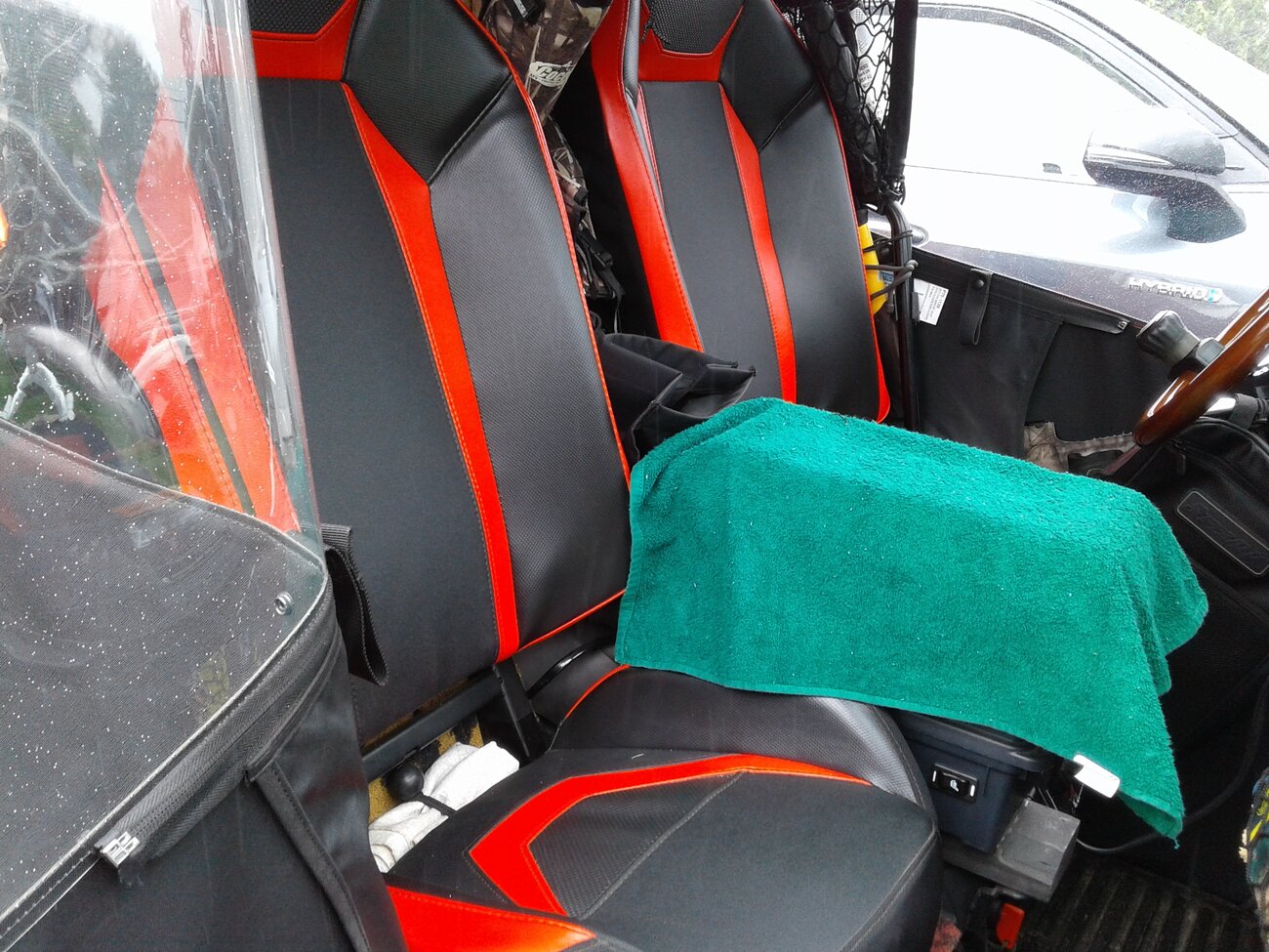

Gal83 : Ref rzr seats.
Yes still in both P500 and P520 since New
Back & Seat -- "Bolsters" -- help hold you in place -- take most of the side to side Rock & Roll out.
Have done three sets of rzr seats in P500/520 ( ALL using same mounting method & with Heat )
Red Seats in pictures are 3rd generation rzr 2020 & up ( more comfortable than earlier gen. seats )
Purchased online: Los Vegas Nevada $331.00 shipped.to N.Y.
Another$50.00 for heaters
Hid the heater wires in a small ammobox between the seats.
Larger Ammobox on top held to lowerbox with push pins "console / storage."
Check for other posts on rzr seats in P500 ( trigger & others </> with different mounting method & console ideas.
Attached some pictures for visual help.

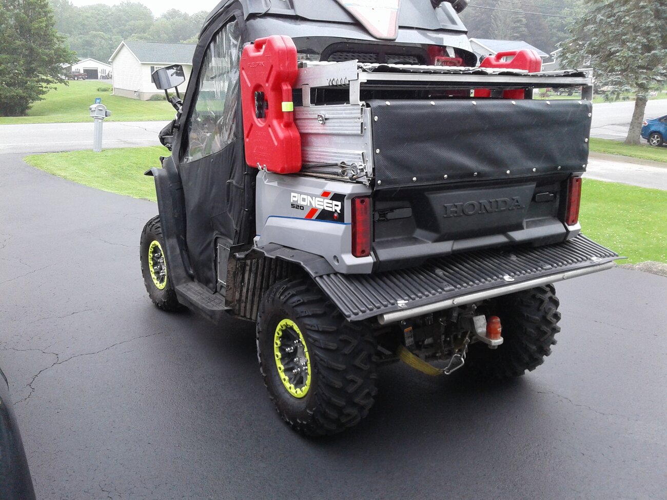

Included a picture of my 1st.SXS ~ I made back in the 70's rode ~ until 1986 Honda came out with TRX350 4X4
1st. Factory SXS 2005 ploaris ranger 500 6x6
