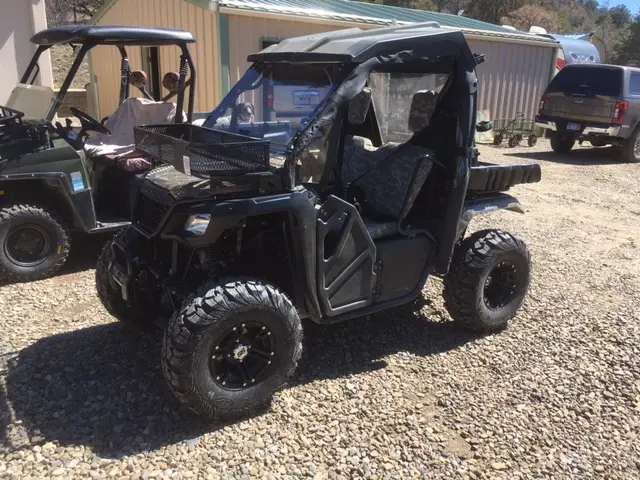

Just so I know, many of my shooting friends are lusting after a P520, are you guys talking about both the 500 and the 520? I have a P500 I bought Aug 2020. I put the SATV windshield on right away and shortly thereafter a front basket. I have had to remove the basket to get inside the hood for a glove box and to do coolant but didn't need to do a thing with the windshield. At my advanced age I occasionally suffer from CRS. I don't want to remove the front rack just to see if I have to tamper with the windshield.
Thanks in advance.
s/f Steve
