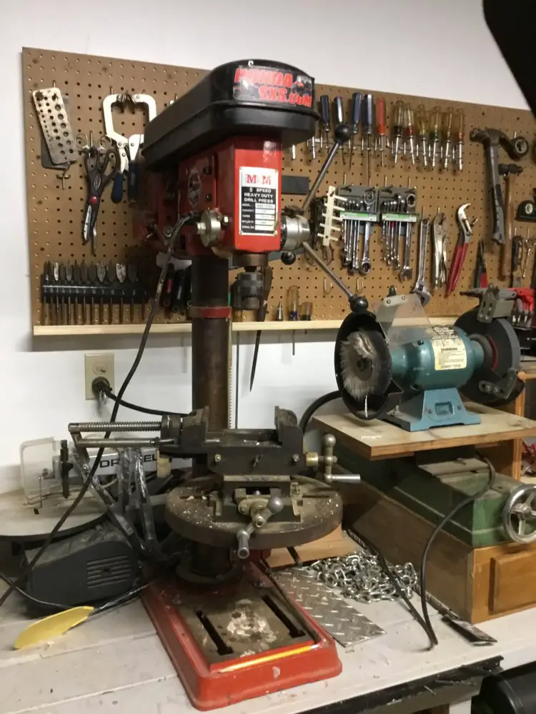

@JTW , would a drill press handle a milling bit? 1/2 inch jaw, 450-2400 rpm.
maybe if you were just plunging straight down into a hole or something , but I would not try cross feeding with it as the spindle in a drill press isn't as heavy as a spindle on a milling machine just my 2 cent's worth. 41 years in tool n die shop.

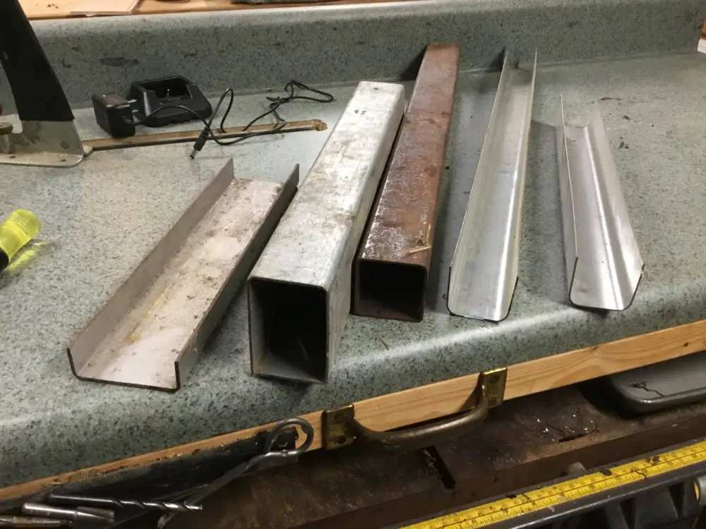

Thanks, was asking for cutting 6 inch slots in smaller gauge channel on the left of picture. Good to have some diverse expertise here.
if the matl. is thin and you drill a starter hole feed slow and easy you could probably get away with it . raise the drill table up and keep the quill engaged as much as possible to minimize flex.

As they said.. it’s not the best idea. And why I went with a mill vs a press.
I have seen a lot of stuff in drill presses and mills turn into helicopters and go flying across the shop sometimes with body parts as well ( just be carefull and go easy ) hate seeing anyone hurt.
