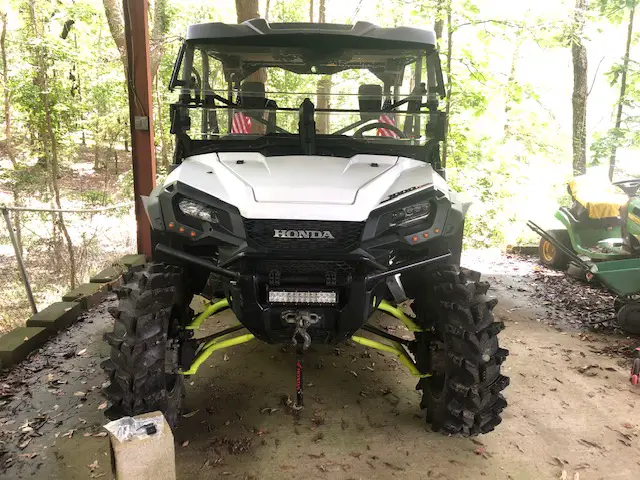

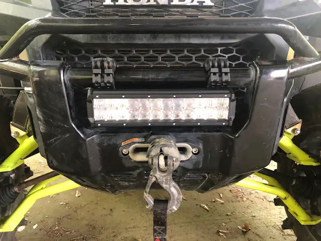

Thank you This is the one I used.
For mounting all you need to do is bend the bumper area the feet will mount to flat with pliers. It’s not much Really easy drill the holes first though. That’s with bumper off
Fits really well and it’s tucked up good, gives a factory look and even with our bushwhacking the light has never been damaged, it’s been on 3 machines in same spot

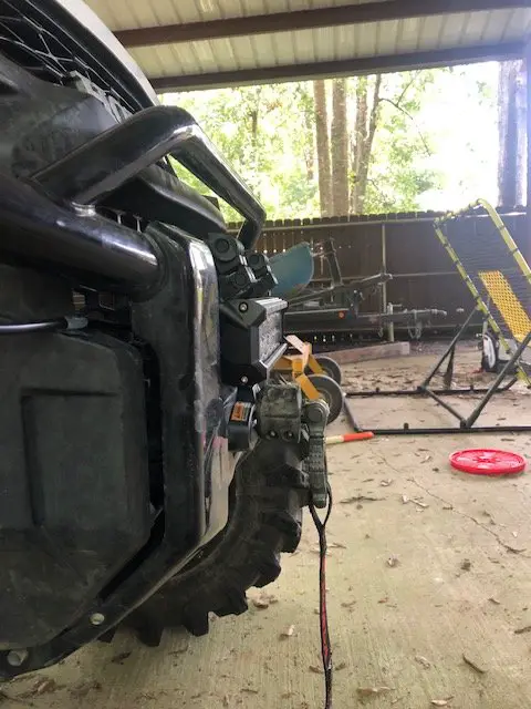

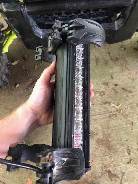

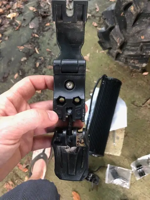

View attachment 28193 12 inch 168 watt here. Fits totally flush. No additional mounts were needed

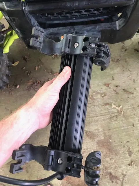

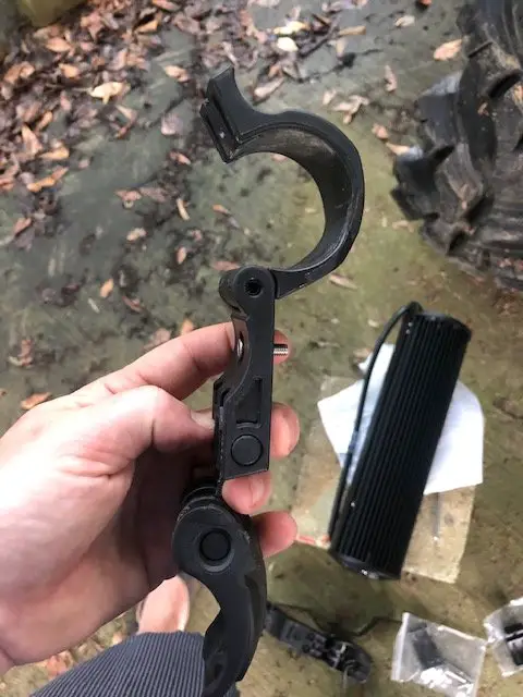

Well its not as clean as yours (couldn't get it set as far back as you) but the goal was no drilling and easy adjusting and so on.
People if you see this and want to know parts read the thread. The hold downs are to original Hondas I had taken off my roof.

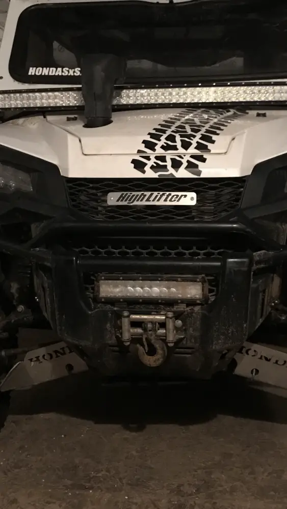

Love my set up with the LE bumper. 5edcf27cc5dca3067e1c38a4620f2cdb
