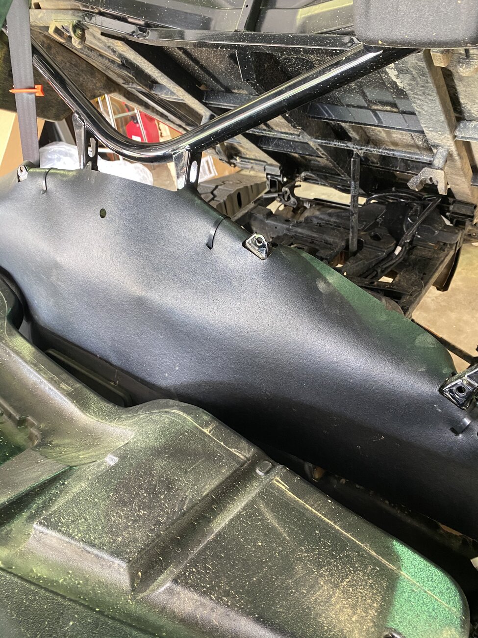

This is with Honda hard rear panel, seals it up pretty good and cuts the noise down.

Thanks for posting this.
What is the material that appears to be thin and flexible sheet? It looks like treated cardboard.
What's behind that thin material? If that sheet is removed is the engine, DCT, and transfer case exposed?

It is thick sheet rubber… The Honda rear panel is the way to go if you want noise reduction. It’s like a truck cab.

I don't know yet. After many message exchanges I was finally able to talk the service manager at my selling dealer into doing this job. I delivered a large roll of 3/8" thick reclaimed rubber sheet to him them ordered a 20sf of Dynamat from Summitt Racing drop shipped to him. He was reluctant to use the rubber sheet because he is going to remove the back wall panel and attach the insulation then reinstall it between frame and panel.
The young woman service writer just emailed an update. She said the "panel" the SM ordered has arrived and they'll photograph the cab insulation process as they do it. I don't know what panel she is talking about.
I'm sure my bill will be significant and hope it will be effective. I'll post them when I get them.

If anything the sheet rubber would be a good backing to support another layer of insulation if needed.
Here is before/after behind the rubber sheet
45F22FE8 37DB 4A1B ADC6 D38C2A4C5B24 3F3C0138 C7DB 4FD4 9AD6 1E3F2BAC6124

My buggy is back from the dealer now and I took several photos that show the interior insulation.
The dealership removed the back wall of the cab and the "x" frame and installed Dynamat insulation from above the bottom of the rear window and most of the way down behind the seat back. He also installed Dynamat on the seat back to compensate for the area of the cab back wall that he could not add insulatatuib to.
I had already installed a substitute for Dynamat on the underside of the roof, on the floor under the Honda floor mat, around the seat base, and on the underside of the seat bottom.
I could brag and bs everyone that my cab is now as quiet as a new Mercedes-Benz but I would be lying. There is definitely significant improvement now but it's still noisier than I had hoped. Is the effort worth the cost and trouble? I think so but it's not a dramatic improvement. I can drive it without my ear muffs now but still prefer using the muffs.
The Honda SxS's are simply noisy as hell! They were not designed and built to be air-tight in cold weather or quiet and smooth.
Your results may vary.
