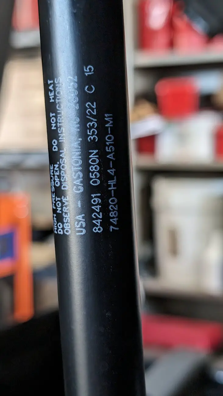

Just checked my strut on my 1000-3 as it is anemic at best and feels like it barely lifts the box. Rating is only 580N. Part number seems to align to the part number above for the 1000-3. Even upgrading to the 1000-5 strut is 55% more force according to @Dirtstiffs-1000 original post of 900N.
I tried to look up the Stabilus #842491 with no luck, to verify specs. I'm surprised that Honda didn't just use the same strut unless the extended length is different as well as the force, as I haven't pulled a measurement on mine yet.
PXL 20240224 152532182 PXL 20240224 152728632

Just order what I did. It will fit and you won't be disappointed. Pm me if you need help confirming measurements and your order.
Don't burn more calories and money, buying another oem strut.

I just measure mine, and it's measures 25.75" center to center with the box fully extended. The 270mm strut extends to 24.8" but jumps from (250mm) $38 to (270mm) $52. The 300mmm strut extends to 27.25" and is only $40. I'll probably buy that one as the box will extend to full height before the rod strokes out. Jumping from 580NM of force to 1280NM will be quite the improvement.

300mm seems too long, it may likely work, but you will have to compress the strut to get it installed, which will prove to be difficult...
Or, you may have to remove the bump stops to lay the bed back further.
I had to push my box up a tad to mount mine.
Make sure you are adding the fitting length in your calculation on the new order.
My 2018 P1000-5
593 mm = ( 23.346") overall length with the fittings.
I Ordered the following -
** 10-23-250(stroke), steel strut- 1250 Newton force.
** 1 - M8 X 30 mm elbow ball fitting- top
** 1 - M8 X 18mm elbow ball fitting - bottom
Jim

I did add the fittings as I worked off of your configuration to start with. I didn't take into consideration the collapsed height of the 300mm stroke, so it may be too long in that regard relative to the existing setup. The force adder above my OEM is the biggest benefit I am looking for, not so much maxing my lift height too.
