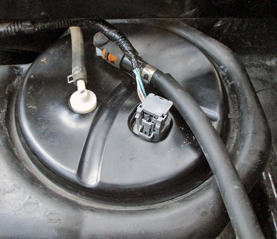

Update 9:
Friday I reassembled my tank after a thorough drain and cleanout. I made sure everything was squeaky clean and assembled with a new gasket. The gasket was backordered and I have been working a lot of hours at the paying job so it has been a while since I've worked on the Honda. The manual recommends reassembling with a new gasket but in hindsight, the used gasket was VERY serviceable with a light washing in detergent. It looks and feels like a huge green Buna O-ring but I'm not sure. The cost was about $6 + $10 to ship.

Cleaned and buttoned up.

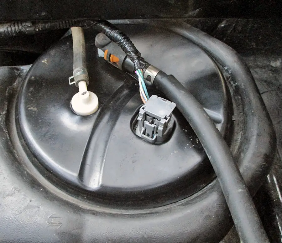

Update 9:
