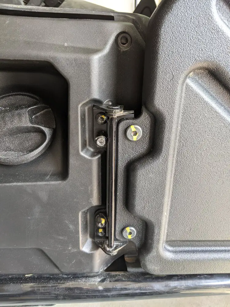

The hardest task is removing OEM Hinge Screws Use Caution they Come Out Hard.
I pulled the hinge pin & door 1st. to gain better access to the hinge Screws.

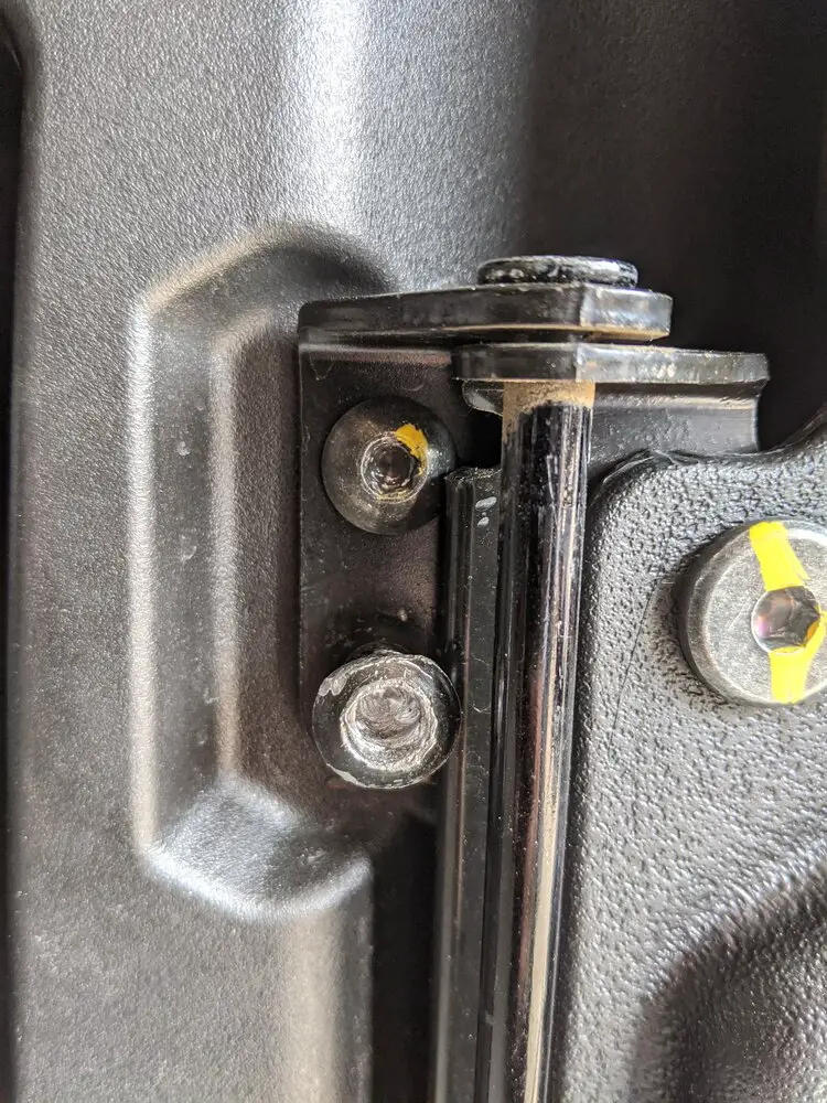

What size torx/Allen did you use to remove those screws?? I can't find anything that will remotely fit snug in the head. I've been sitting here staring at them debating on just taking it into the dealer and paying them to install the doors...I have the Honda manual, install instructions, and the owners manual in front of me and I cannot for the life of me figure out what size these bolt heads are.

I would advise taking it to the dealer lol...hopefully they can get this focking thing off...couldn't get it even with screw extractor. These factory tightened screws with weird bits are driving me bonkers

Looks like a sucky job. I would try drilling them out a bit first then the extractor. Good luck.
It was brutal...spent a long time slowly trying to work the extractor in using multiple smaller drill bits. So weird...some of the screws previously have come out fairly easy, while others seemed like they were tightened by satan himself. Frustration nation over here - waiting on a call back from the service guys at the dealer now to see about labor cost to have them installed. I'm also going to ask if they have some sort of special bit I can also get for the screw heads.

A size 5 Aallen Metric Socker ( 3/8 drive drive ) is what I used .
Lots ofPRESSURE pushing in & SLOW Firm PRESSURE to turn Ratchet. ( forget any power tool for this screw removal )
As for the stripped Head - Drill a small hole in the center - then Drill the Head OFF - the remaining threads will be much easier to deal with - after Bolt Head PRESSURE is released.

Haha I saw your PM...but it was already too late. I spent almost 2 hrs trying to get the 1 door hinge screw out -I'm doubtful that even if I would have gotten the hinge pin out, that it would have helped....and wasted a full day of hunting dicking around with it. (#nohomo)
Called the dealer this morning...$170 for them to install the doors. Dropping it off, picking it up, and done thinking about this debacle (they can deal with the stripped screw) 🤣 Good learning experience for anyone down the road though. I'm also going to ask them about the specific bit for those screws.
