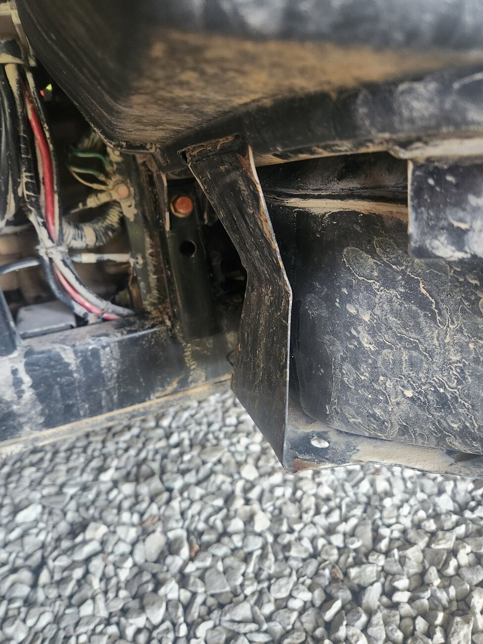

-The SSS plates have more coverage, including protecting the bottom of the fuel tank (which has its own thin layer) under the passenger seat. Just went and looked at KG's buggy; the fuel tank 'skid plate' support bracket is bent, mine are still straight.
