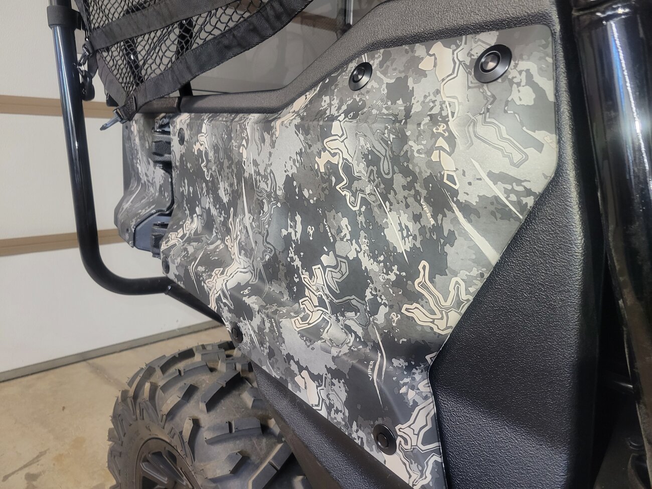

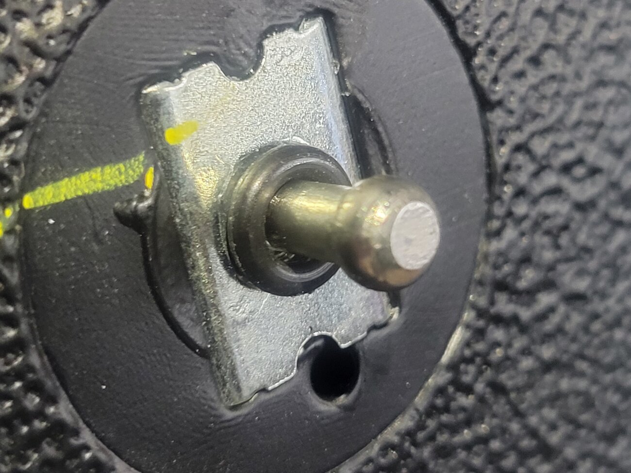

There is an advantage to using threaded inserts and 6mm screws, especially for the rear panels. That makes it easier to install the quick release "hood latch" type buttons (which happen to use the same size metric screw for the ball end fastener as the original screw) to fasten the panel in place so you can use the space inside the doors for storage.
20210707 175448
The ball end pin, above, has an O-ring on it . . . this is to seal dirt from the button mechanism.
20210707 180053
Reactions: ChadD and JenElio

The hardware kit provided with the panel kit doesn’t have the threaded inserts like in your pic. They’re a rubber expansion plug with a brass insert and requires a pretty decent sized hole in order to fit. Thus my reason for using push pins, hold the panel up drill the hole and stick the pin.
Well nuts (threaded rubber plug nuts or whatever) will work fine, larger hole notwithstanding. The 6mm - 1.0 size will allow use of the large space inside the rear door for lighter things.
20210707 175851
The blue modeling clay is temporarily in place to measure the thickness of the weather strip needed to help keep dust out of the storage "bin".
