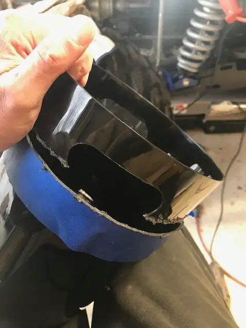

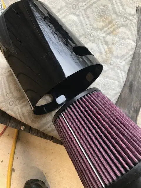

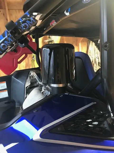

Here is what I did. I bought a trash can from Walmart and cut it down. Then I drilled a hole through the top of the filter and put a stainless steel bolt though. I put a lock nut to hold the bolt, then I drilled a hole in the cover and used a washer and a wing nut to hold it on. I also put a washer on top of the lock nut so the pressure from tightening the wing nut was distributed.

Thanks, that is what I did, already found your post about this, came out good!!

So the can is slightly larger in diameter than the filter so it lets air through, but keeps the water out? Nice job.
