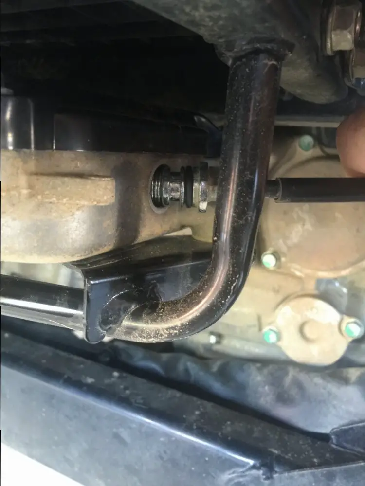

Image This is the actuator that pulls in the cable to lock the rear. As you can see in the pic it is not secured. It will just pop out by lightly pulling on it. It was like this when I looked at it. Can someone check and see if yours is the same way?

View attachment 7257 This is the actuator that pulls in the cable to lock the rear. As you can see in the pic it is not secured. It will just pop out by lightly pulling on it. It was like this when I looked at it. Can someone check and see if yours is the same way?
I looked as mine and switched it a few times. Mine is attached...but I can turn it... wondering if these are suppose to be loose... not like yours , but rotate?.. Mine is not tight but it is not doing what yours is doing...
I also played with the changing... It does take a bit for it to change... I think it is so many revolutions of the gearing. Turf Mode is just the rear two wheels lit on the display and when you go to possi 2 wheel it shows a lock under the wheel image.

It looks like it for sure needs to be sealed and movement to actuate is lost in cable float.
Thinking back to when you first got it did you notice if it worked right then? Can you see if there are any impact marks from a long rock or stick?

It definitely has not been damaged in any way. I need to make a video and show you guys. I just drove it all over the yard in turf mode, the 2wd lock light is not on, but it is definitely locked and I have shredded grass to prove it. I was hoping my local dealer could help me out with this today. I took it in for the initial service only to be told they couldn't give me a price to do it because the 1000 is not in their computer system yet. After 45 minutes and them having to look at the owners manual that came with my machine I left and decided to do all maintenance myself. I'm gonna just drive 2 hours to the dealer I bought if from and have them look at this issue. I also need to have the door issue looked at. The passenger door has to lifted up to close, hoping they have a re-engineered door from Honda to fix it.
Let me just say overall I am very happy with the 1000, just need to get a few bugs worked out.

Ok. Problem solved on the 2wd lock issue. For the rear end to open up and go into turf mode the cable has to be pulled tight, this way if the cable breaks it fails into locked mode. On my machine the cable was never pulling tight enough to take it out of lock mode all the time. Under the rear drivers side feet there is a small access panel to get to the cable mechanism. See the attached pic. The cable from the 4wd selector comes in the front and pulls on the adjustment bar which in turn pulls on the rear end cable. It had so much slop in it that it was never pulling tight. All I had to do was adjust out the slop and it works like a champ now. This is easily accessed by removing the cover and them 4 10mm bolts on this overly complicated cable junction box. This is also why my cable was basically falling out of the box.

Cool! Thanks for opening that up and shedding light on it. Is there inspection paint on any of those surfaces to show it was looked at before leaving the factory?
