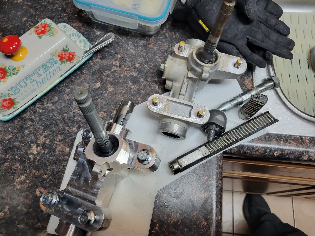

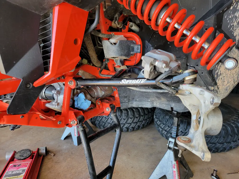

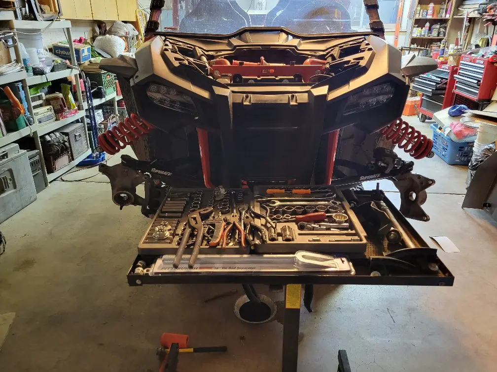

No one has done a comprehensive write up on doing this job on any of the forums, that I'm aware of. I'm just buttoning up the job and I have about 20-30 minutes of work left tomorrow. I started working on it Sunday but had a ton of interruptions. I've got about 6 hours of work into it so far. It could be done much faster, no doubt. If I did it again I could have the front of the car apart in an hour or so and have the new rack and the car back together in another couple hours. Not having any guide or anything I was being cautious, going slow, and thinking everything through.
I'll add to this post once I'm done.
View attachment 324439View attachment 324440View attachment 324441
I'm getting ready to remove my diff to install a torq locker kit and decided to replace the rack while the diff is out. I ordered the 1.5 to 1 rack from RB3 last week and still no word on how long of a wait it will be. How long did it take to receive yours?
