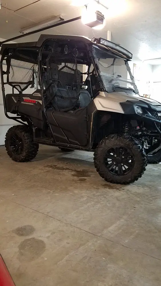

Me and a friend both have 1000s and upgraded our shocks. So with 4 front shock laying around decided to see how they would do on my brother in laws 700. Like stated the rears went on with no modification. The fronts however we had to grind down the bushing to fit into the front mounts and with a set of spacers from RB3 everything went right together.
Also got a set of RB3 Wheel spacers to run the 1000s wheels. The setup seems great can't give any good feedback on performance yet but hopefully soon!

I havnt done a whole lot of research on the self leveling shocks but how do they work ? It seems like the # would be to stiff for the 700.
The rears off the 1000s are to big in circumference to fit the 700.

How much lift did you get front and back? Also how was the ride compared to stock ?
3 inch lift in back.
3 inch lift in front. The front had spacers from SATVs 3" lift kit.
Took the spacers out before ever testing. Didn't like the spacers, they had the front end standing to tall for us.
I took those measurements on stock wheel and tire setup. Then I took the spacers out after I put the 1000s wheel/tires on. It dropped 1" in the front after the spacers came out but it looks better!
Haven't got to get it out for a real test. That should change next weekend.
