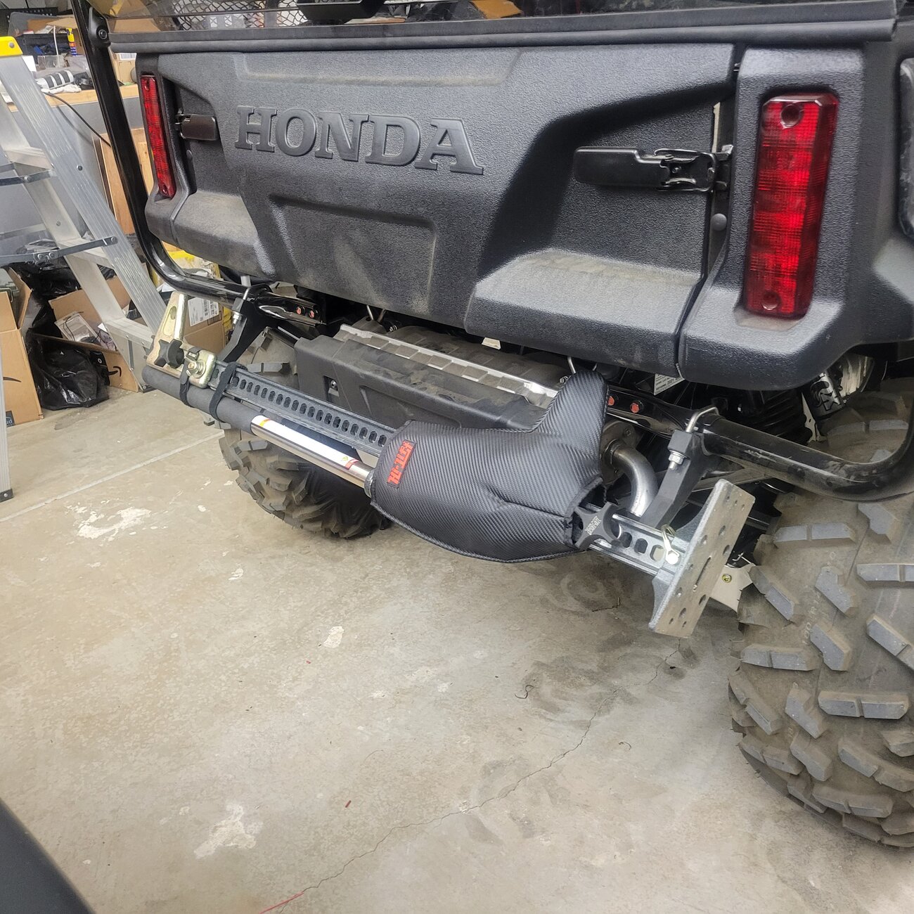

I just posted this on another thread. Not really a bumper, but the jack does double duty.
20210819 221858

What mounts are those? Ultimately this is what I might still do.
They are (click on link) High Lift Jack Mounts
I cut a short piece of 1.75 ID tubing and split it lengthwise to "reinforce" the roll bar tubing where it's clamped on, though I don't know that is necessary.
Should add, I have to remove the jack (but not the mounts) to dump the bed.

good stuff. wonder if someone could fab a bracket that allows the jack to mount and the bed to dump as well
I suppose it could be done. The other considerations are departure angle, I thing the mount needs to be positioned so that the jack won't hit when your butt is dragging. That, and given how easy the jack is to remove (just two screw knobs), and how seldom I use the dump bed feature (I do use it sometimes), I think departure angle is most important.
I did play with mounting the jack inside to the upper roll cage, and that was my original intent, but pushing 80 years old, that would be awkward for me to access. The "bumper" idea has worked well.
