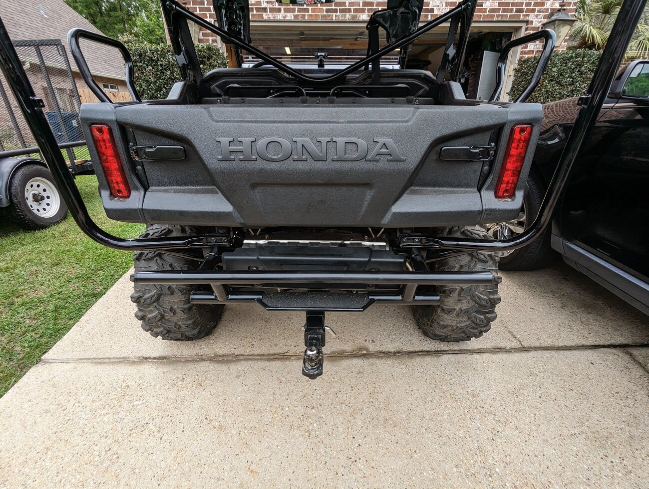

I have a 2016 P1K-3 with a Honda rear bumper which attaches differently than the P1K-5. It still attaches to the bed however. Mine has been on at least 6 years and no problems. Thankfully I have never needed it. I got it,"just in case".

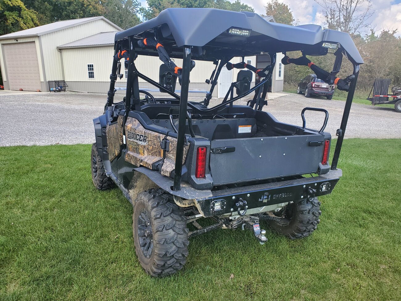

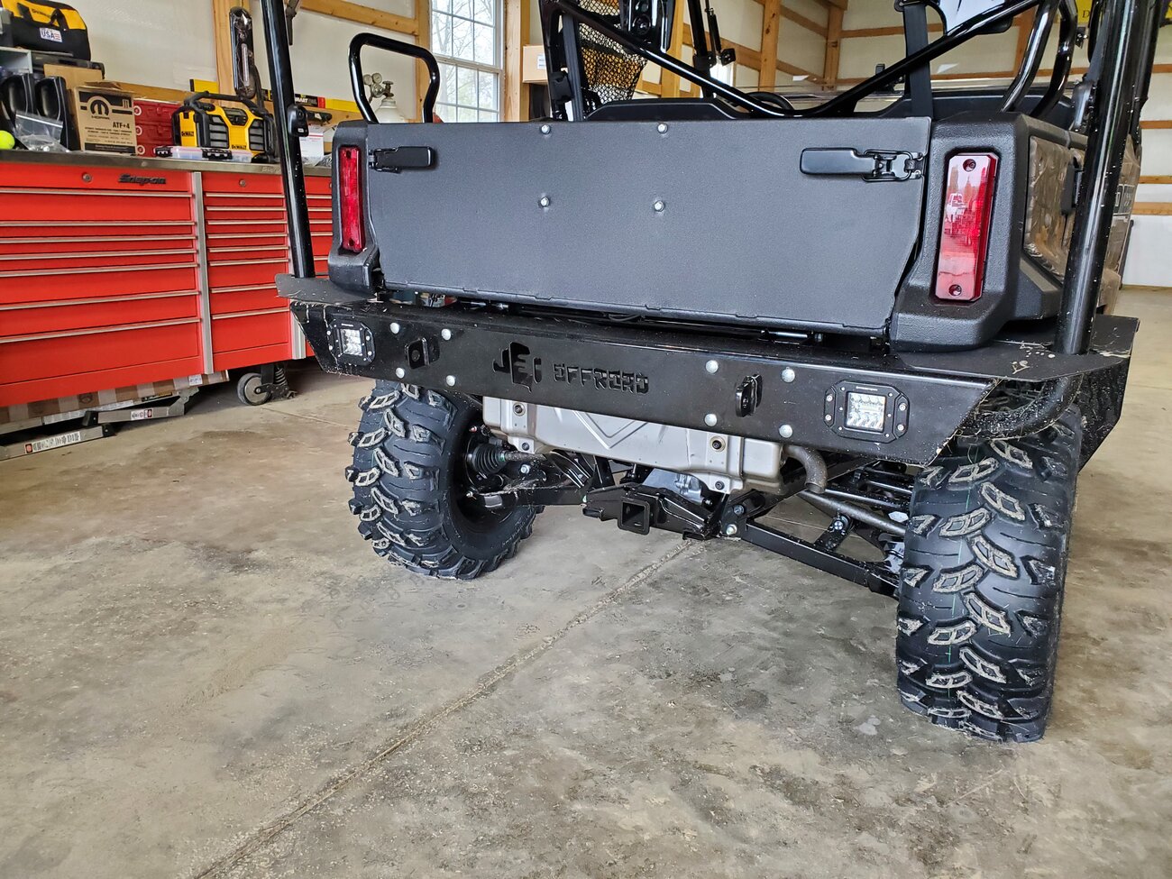

I have the JEI. It also attaches to the bed. It pivots with the bed so the bed and tailgate are both fully functional. The downside is you also have to buy their steel tailgate for it to properly open. I needed a little bit heavier tailgate anyway so it didn't matter to me. I had great experience with CS but I know some haven't.
