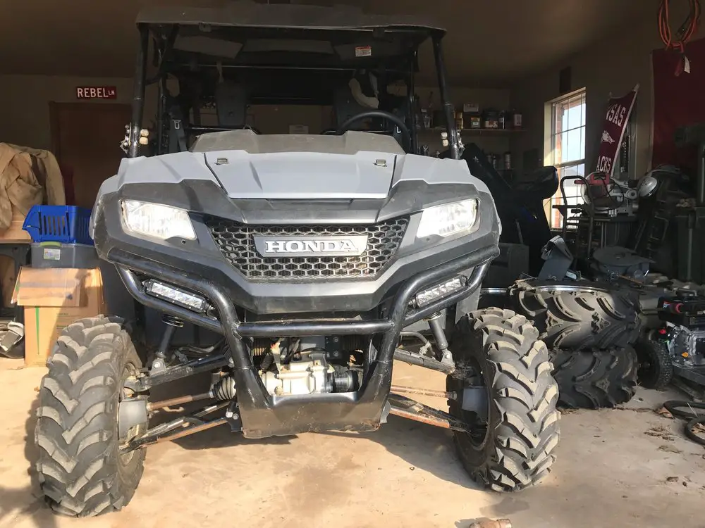

@USMCsilver, looked back at my order history. Looks like I ordered the 1.625" for the rear lights that attach to the roll bar and the 1.5" bracket for the push bar cross tube to mount the front light.

I need a set of those front mounts! Are they aftermarket or did you fab them? I was gonna have some made, but I like those a lot.
I made them, they don't look very robust, do they have yet to be ripped off or bent and I've moved a lot of branches out of the way with them lol,
