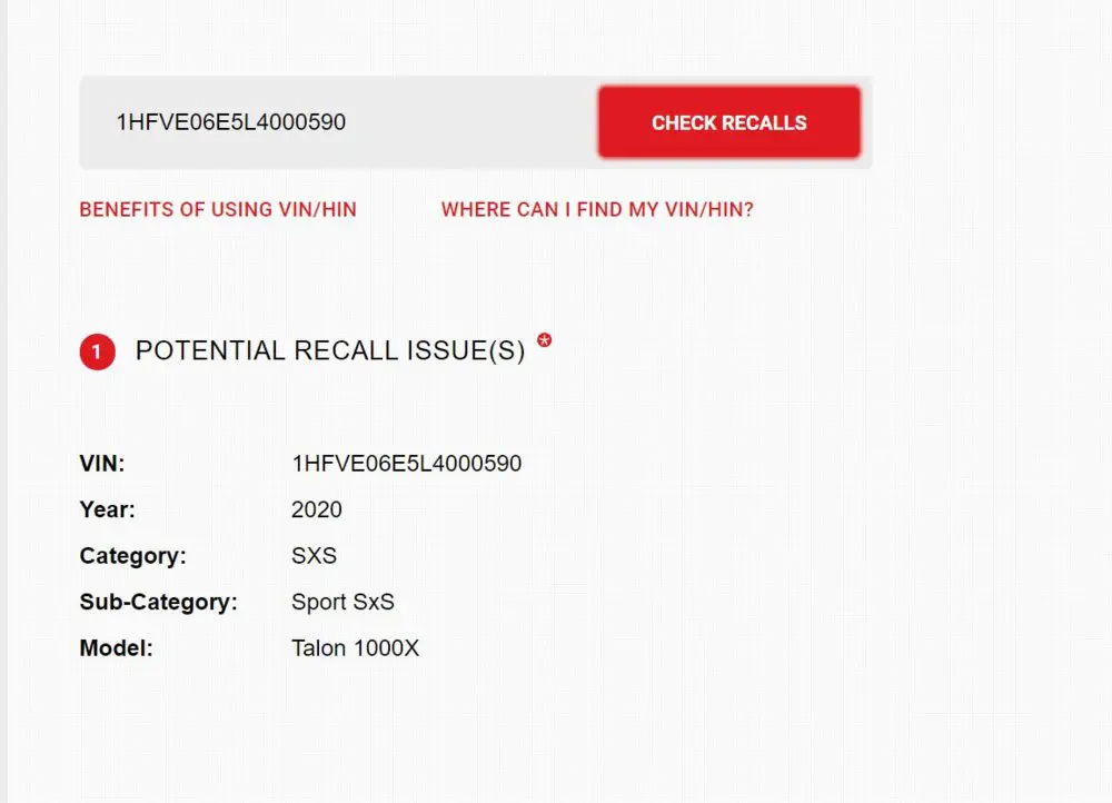

Is this something you can do? If so, this is my VIN 1HFVE06E5L4000590
If not can you tell me where/how to find out if I have an affected VIN? Thank you!

I ran mine through the Honda recall site Recalls - Honda
I'm not sure it's up to date yet though, mine was the same.....listed as "Potential Recall Issue"
Here's yours @Montecresto

@906UP Mine says same thing as yours.
I suspect they all say that right now. I'll do the inspection myself & if it needs repaired I'll probably do it myself, the part is less than $1.50. It'll be a good winter project.
Hey thanks for that....can’t see all of it though, are we affected?
Oh, I mean thank you @906UP...👍

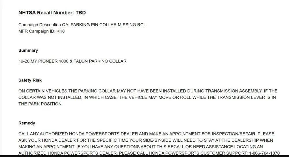

3-23-2020
Honda issued a SAFETY RECALL on CERTAIN 2019-2020 Honda Pioneer 1000's and Honda Talon 1000's.
This recall is to inspect for a missing parking collar in the sub-transmission.
PROBLEM - It has been identified that a limited number of units were assembled with a missing parking collar. A missing collar could cause the machine to roll while parked increasing the risk of a crash or injury.
AFFECTED UNITS - Only CERTAIN units 2019-2020 are affected identified by serial number. ONLY a limited number of units will be missing this collar.
NOTIFICATION - Honda will notify all AFFECTED owners in April 2020 via mail.
SOLUTION - The solution will require disassembly of the sub-transmission to replace the missing collar.
HOW TO CHECK MINE - The full list is NOT available to the public. Dealers can check your S# to see if it is affected. The online Honda Recall database is not up to date.
For more info, ask your dealer lookup Service Bulletin dated March 23, 2020, on iN
