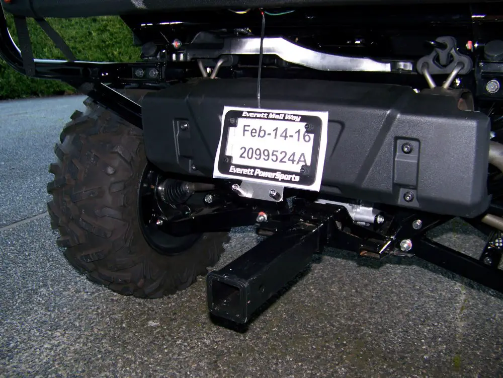

Had problem with license plate in way from dealer, extension solved the problem and easier to reach.
I can see a big ole rock just waiting to tear that off in the wrong situation, where I normally ride I might last a day before a rock shelf pulled that extension and the hitch up and off as the rear end drops down, hope you don't have any issues but there is a reason the OEM hitch doesn't stick out.
Appreciate the concern. It is actually higher off the ground than it looks and comes off with one pin. It will work great with my new deer/ elk hoist, 500 lbs. for gutting and skinning. Most areas where I hunt are very tame, no mud holes or deep ruts. Bring chain saw for trees in way and winch my way out of trouble. Will probably keep it in bed till I need it. :)
