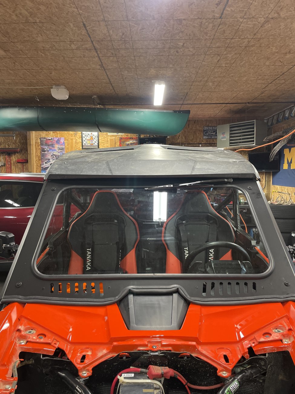

don't discount rolling your own it ya have time, local scrap yard can be your best friend, .190" scrap sheet, a little pattern making and I then cheated, dropped into auto cad, my buddy has a plasma cutter, Shazam, windshield frame.... dropped off at glass shop for glass/gasket...integrated into roof.
regret, didn't do manual windshield wiper...yet.
regret - overcomplicated vents
Is that aluminum he used, and how thick would it be ? You could easily use the original rubber from the top and bottom and sides. I did some metal work and am a jointer by trade, so it’s really just getting the aluminum. Cool

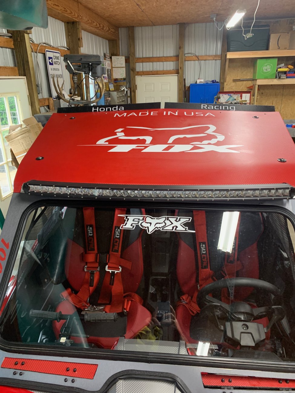

Looks really good. Wish you were closer so I could take a good look. But that’s what I want. No more plastic. 😊

thanks - Ii used aluminum, think the glass shop used trim-lok for gasket, no issues....I bought the bottom gasket on amazon
could also get away with .25" steel sheet, rattle can it color of choice, glass shop can help with if .25" is overboard...those trim-lok gaskets have a range they fit in
I live in coal cracker land, so some local inexpensive glass shops, they are always replacing glass on the mining heavy equipment

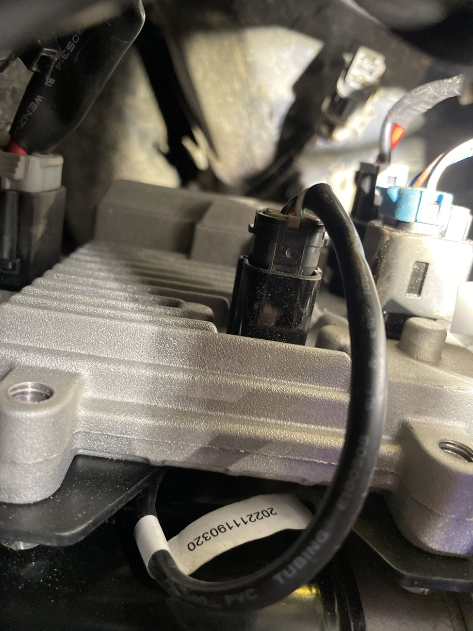

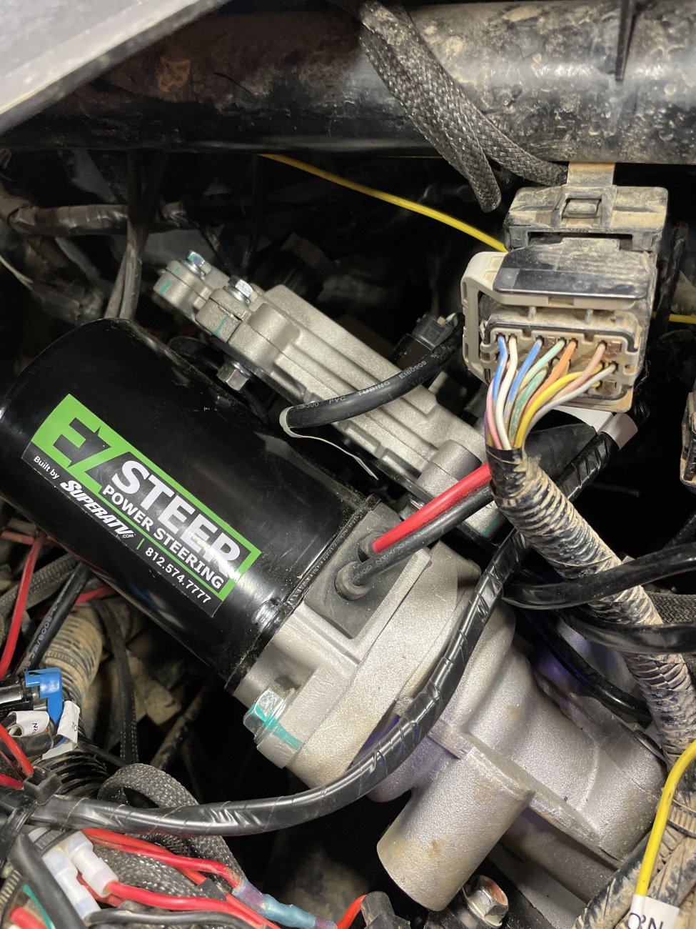

Alright! The power steering mod/upgrade is done. I must say what a kight and day difference. Simply mint! If any of you have a pre Talon factory upgraded power steering, this must be your next mod/upgrade or your foolish cuz we all know if u have larger tires you will have dead steer and that aint cool or safe.
Back to the install. Its involved but worth it. Just take your time or use @TerryH video to help with your install if the SATV instructions mess u up! But they shouldn't. They are straight forward. Also, Terry had a great mod to get rid of the PS light on your dash. At the PS module under the drivers seat, there are three molex’s. One will have a mess of wires coming out of it, cut the yellow with green chase wire and connet a small pice of wire and connect to it and then hook it to the chassis ground right behind it and your good to go. No more light.

Pics of the finished PS on mine
