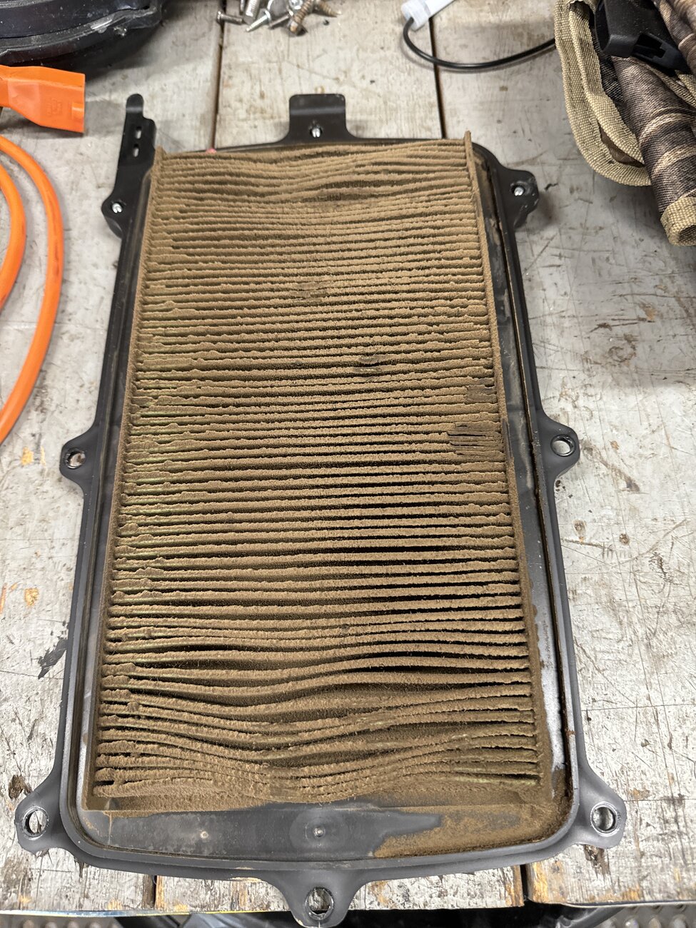

Changed my main air filter. Dont know WTF happened here? Got the 10-80 pre filter and I clean it regularly. All I can think is before that, i had pro armor snorkel with a frog skin for about 400 miles before the pre 10-80 and we have dusty sandy trails. So got a new one coming tomorrow and we will see.
ya mine wasn’t that bad at 3k with the 10-80
20,271
115,929
My first filter after the 10-80 kit looked like that when I was using the Dessert Craft filter, after I switched to the oiled Uni I've been on the same filter for 2 years and it's still green. The DC filter doesn't do well on our silt/sand dust UP here, probably the same where you ride Rem
Funny its called desert craft. If its doing this here, imagine how it works in the desert🤣

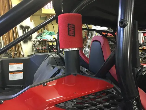

Same ones I've been using since I saw HondaBob's snorkel idea, he provided that same UNI number - UP-6300ST. I also have 3 that I keep in rotation.
Long before 10-80 Sports came up with his idea -

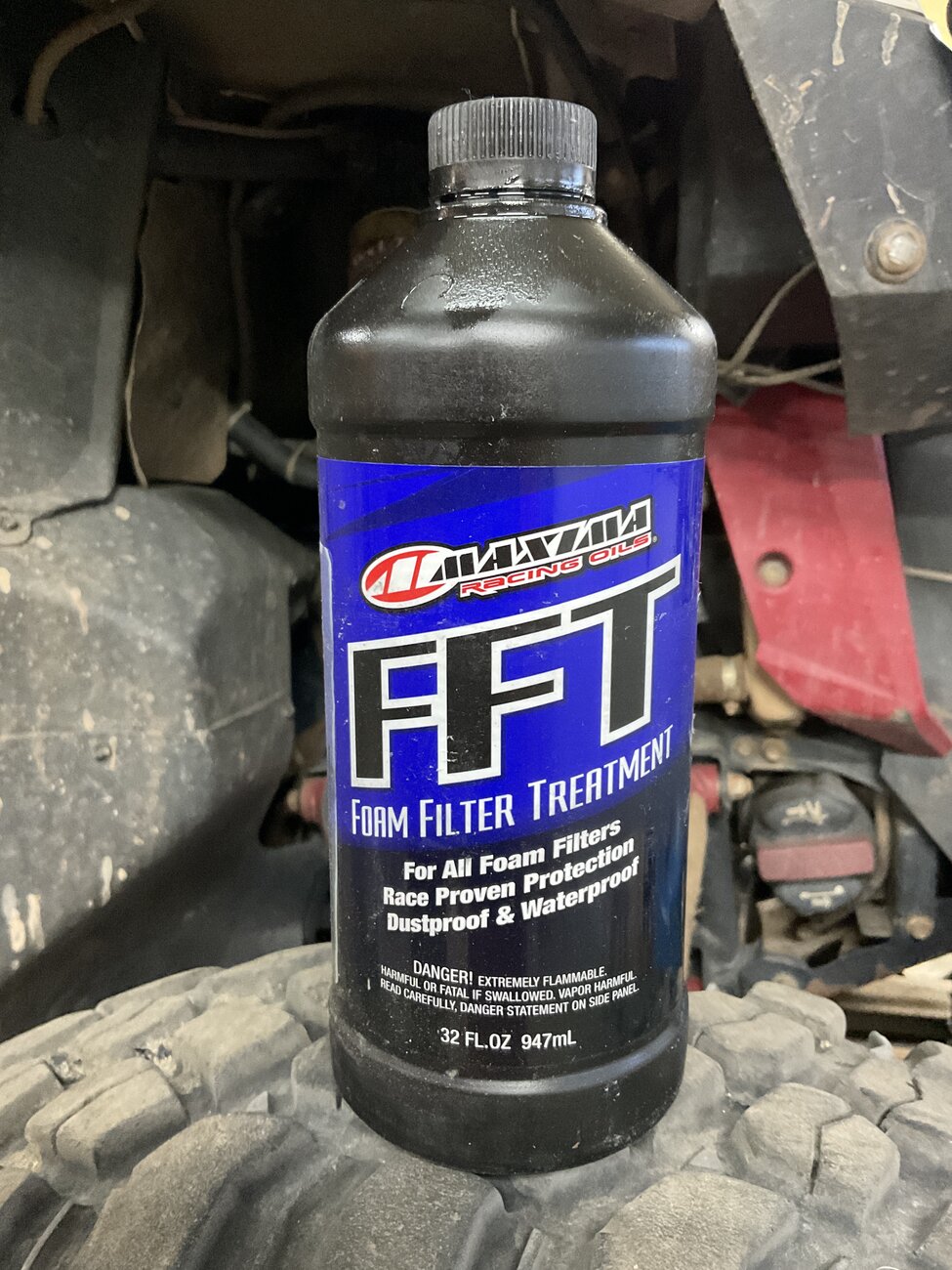

@906UP what oil are you guys using for the filters?

I finally broke down and bought some of this proper foam filter lube. But I don't like it near as much as the plain ole straight 40W I've been using on the dirt bike filters for 50 years. It's too thin and drips on everything before I can get it worked into the foam. I don't like the spray on, way over priced and lots of over spray IMO.
The biggest problem IMO is that the red outer sock dries up and dust doesn't stick to it like regular oil. IOW I can see that plain 40W is grabbing dust but the filter oil doesn't do that, it looks like I forgot to oil the filter. :(
Just as a thought🤔
I wonder if the K&N oil would work on the
10-80 filter? Its kinda the same filter. WhenI used it on K&N’s they stayed sticky for a long time. Plus I have that sock on there. Just a thought.
I'm w @CID on this one and use straight 30W, the cheap stuff. It always worked back in my racing days and remember.....it's just a pre-filter, I don't get crazy with the oil, just enough to make it damp. I've tried the fancy "air filter" oils in the past, waste of $$ imo.
10W-whatever and a plastic ziploc baggie - priceless……
