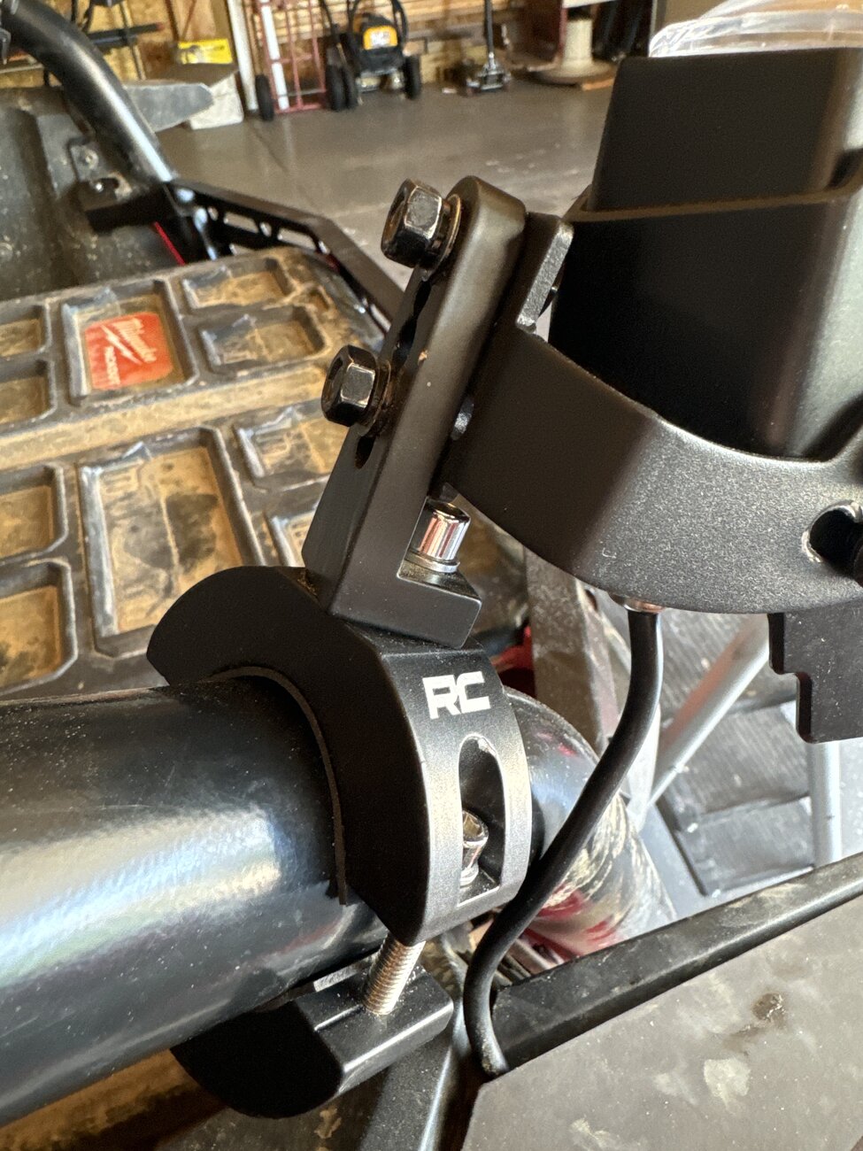

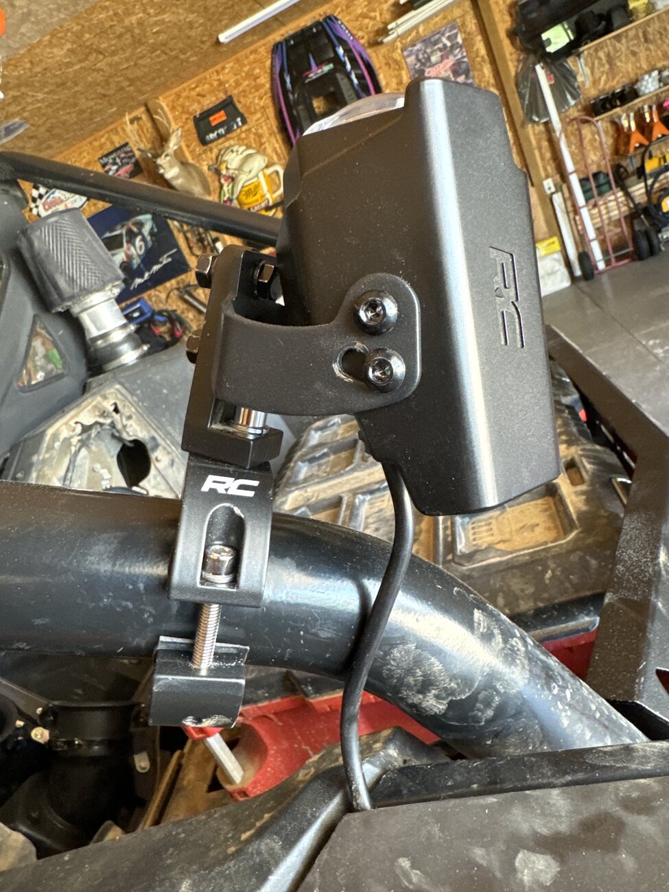

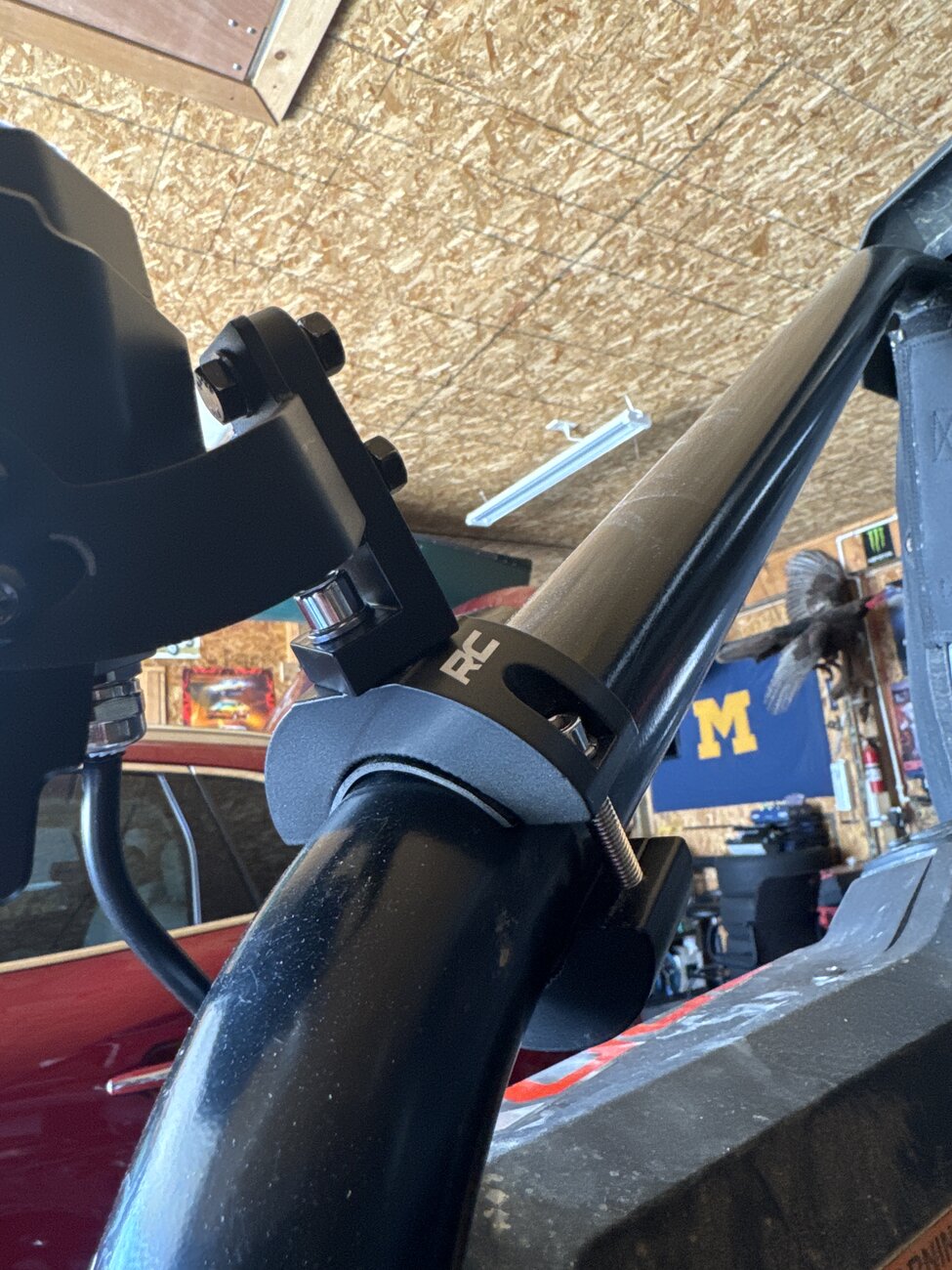

Thanks, looks very similar to how I mounted mine
The only $hitty part being this way is the angle. They a slightly back instead of straight up with full adjustment to both. I can live with it tho. Couldnt find a good bracket to correct that. One nice thing is the laser mounting bracket can pivot.

I'd cut a relief in that bed plastic or the rear quarter panel where your wire is going in so it doesn't get pinched/cut if you put that into a bank/rock. If it's not a b**** to do now that you've run it, I'd tuck the wire along the inside of the ROPS where it's already got a relief cut for the bar.

Im gonna cut a spot there. My wire runs between the MB’rs and the factory fender zip tied to the factory wiring under there then back up the wiring above the air filter nice neat and tidy. Seemed to work well without issues the last few years with the whips. But deff will be cutting a relief for the wire.
