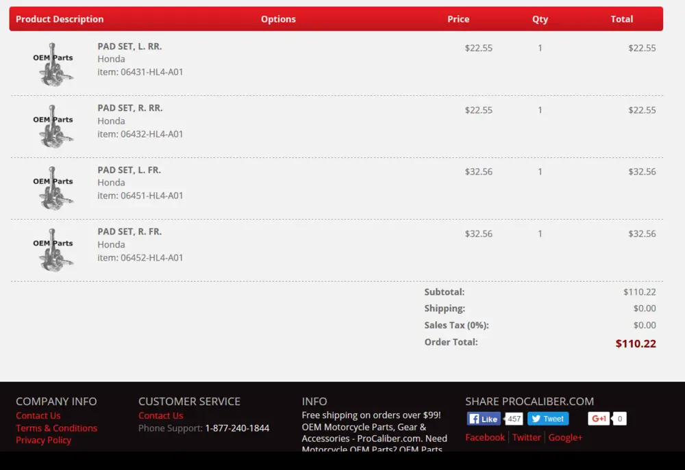

I just ordered a set of front and rear pads. If I remember I'll do some picture and send them to you @Hondasxs.
