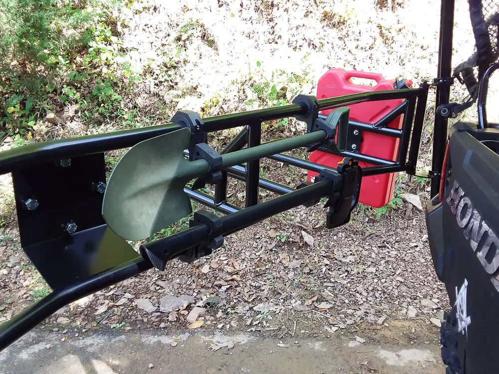

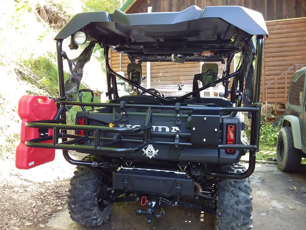

After the big clean up yesterday, it was time to do some installs today.
First up was the V2 rack from BCF. I really wanted to have this on by the Mayhem ride, bur after watching @JenElio smack the snot out of his rack while we were going over those humps I'm kinda glad it hadn't made it in yet.I'll probably take it off whenever I head back to RRB.
Also added a fuel can. Again, a no-go for RRB, it adds about 1inch of width, and as I found out last weekend when threading the trees, the Squirrel's a$$ is fat enough already.
To the rack I added some mounts and Quick Fists to hold an axe & shovel. Simply put, I added these for the same reason I put on the fuel can, because I love my wife, and don't want her to experience any difficulties while riding. If we were to get stuck, I'd hate for her to have to dig a hole or take down a tree with her bare hands while I'm drinking a beer and telling her to hurry the hell up. I'm considerate like that.
I finished up by putting on a Big Sky gun rack.
All done for the day, and not a moment too soon. Its almost 4:20!;)
I have the same gun rack and I luv it. Had a 10ga and 12ga in it this turkey season. I wasn't sure how it would do with that much weight but it worked perfect.
You'll be fine with that rack back there, mine is a POS I put together in a hr and its held up pretty well for what it is. And from the looks mine sits about 3"-4" lower also, shouldn't bother you there at all. And in my defense those humps weren't behaving so I had to smack'm a bit 😂😂

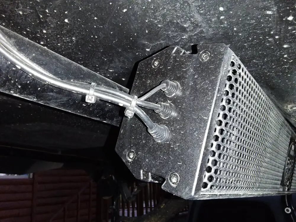

Where did you find you stereo? I’m guessing it’s Bluetooth?
It's a Boss BRT26A. Will take input though Bluetooth, USB, or anything on a 3.5mm cable.
20201001 191656
I primarily use it with a USB Flash drive, although have used BT as well.
Coming out of the unit are 3 lines - 12v power,and two inputs, one USB one 3.5mm. Power line is about 6 feet, the others a bit less. I bought extensions for the USB and 3.5mm, and ran them under the hood with the power line. I had snipped off the original 12v cig plug and extended the 12v line.
20201001 191741
Next I found on Amazon a panel plug the had both wired inputs I needed. I connected the extensions to it and it sits in the upper right hand corner.
20201001 191707

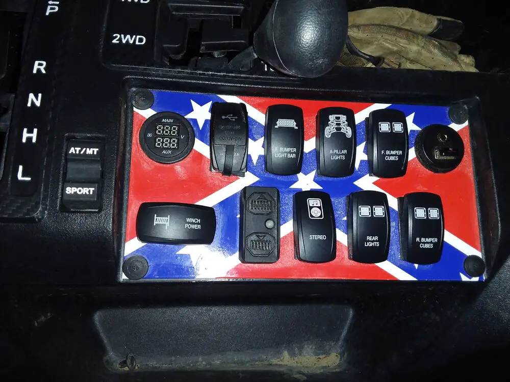

I didn't want to have to have the key on to listen, so I wired it through the switch to the battery.
I know, I know, I might run down the battery, but if that ever did happen I must of had a REAL good time!
