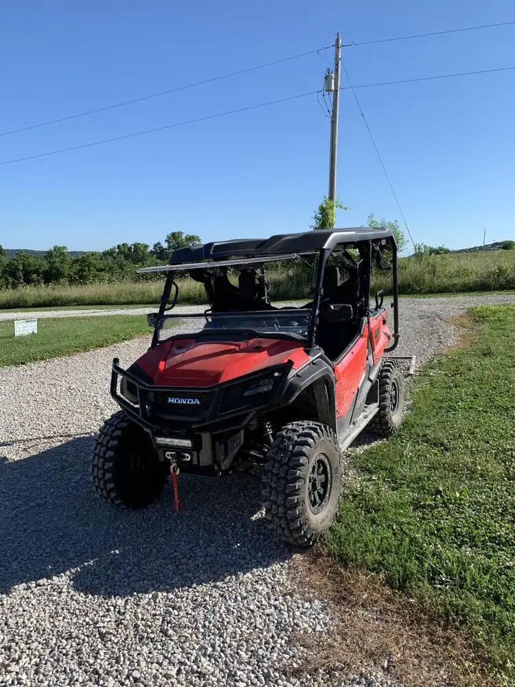

I put a highlifter 2-1/2” bracket lift on my 2016 P1000-5 love the looks but I noticed it stiffened up the ride a little an got rid of almost all of the sponge side roll it handles much better.
