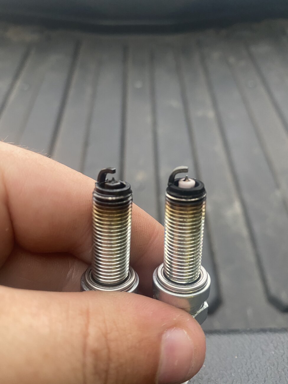

Update
After finally getting my P1K3 back from its first service, recall and having them look into my problem, nobody could give me any answers. I finally said screw it, picked it up myself and got back home. I finally got under there and got to digging. Started with the plugs. Pulled them out and this is what I found. I put two brand new ones in there and she runs like new again. 89 miles on the machine. I’m thinking maybe the fuel pump (which was recalled and I had fixed while being serviced) wasn’t pulling enough fuel and killed that plug, which led to my problem of rough idling and stalling. Simple fix! Yet nobody from Honda could do it or took the time to do it!

More than likely caused by short trips without getting the machine hot and "cleaning" it out.

Agreed. My 2019 Pioneer 1000 EPS did the same thing as the OP's. It has around 45 miles on it and I am guilty of not running it long enough to get it hot.
$44.00 later and it's back to normal. I guess it needs to run 15 minutes or so to make sure the plugs aren't wrecked again.
While it was idling, I heard the electric fan on the radiator turn on. That was probably the second time that has ever happened. :D

It's my understanding that plugs 'burn themselves clean' and if they never get up to temp, deposits will continue to accumulate until the plug fouls - doo doo on the insulator will provide the spark a path to ground that's easier than jumping the gap.
