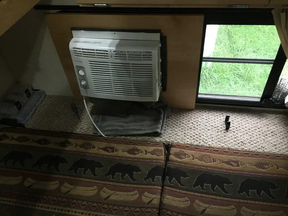

Well, currently it's 81* outside and 67* in the Hawk. I'm loving that for Sure!

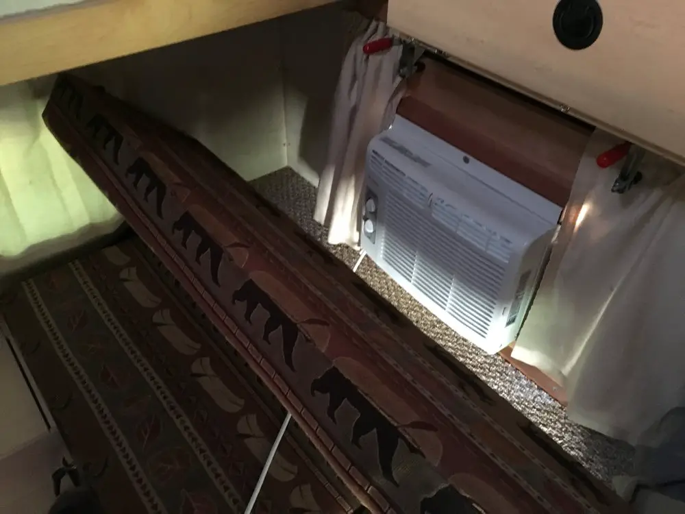

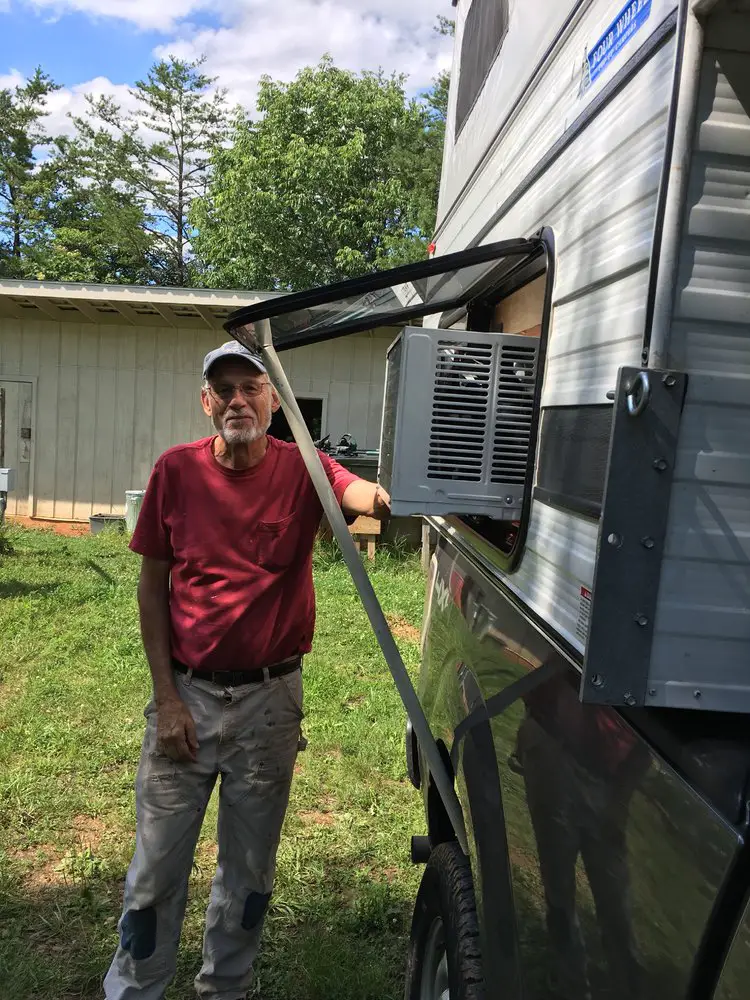

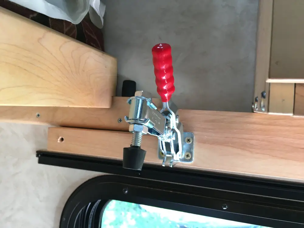

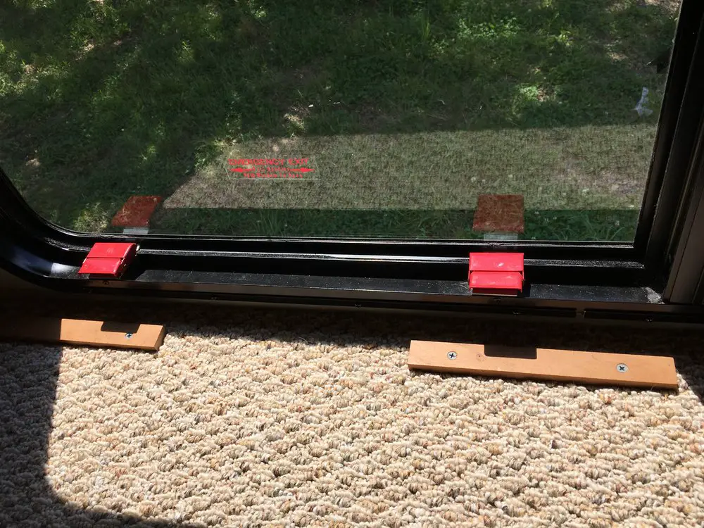

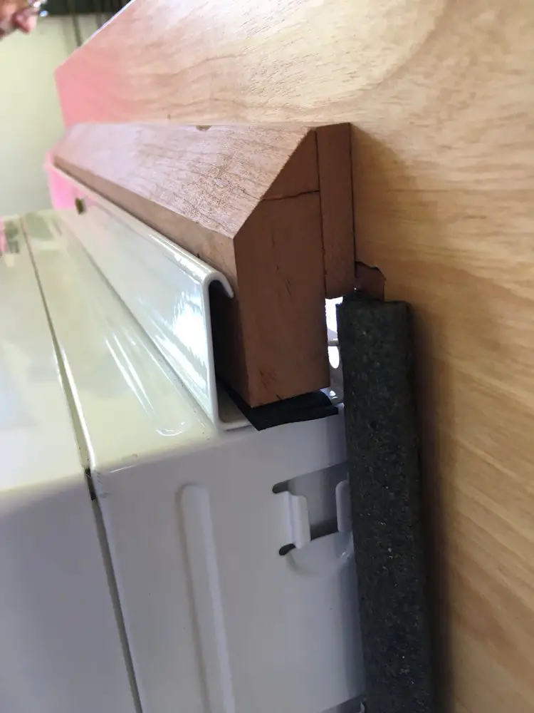

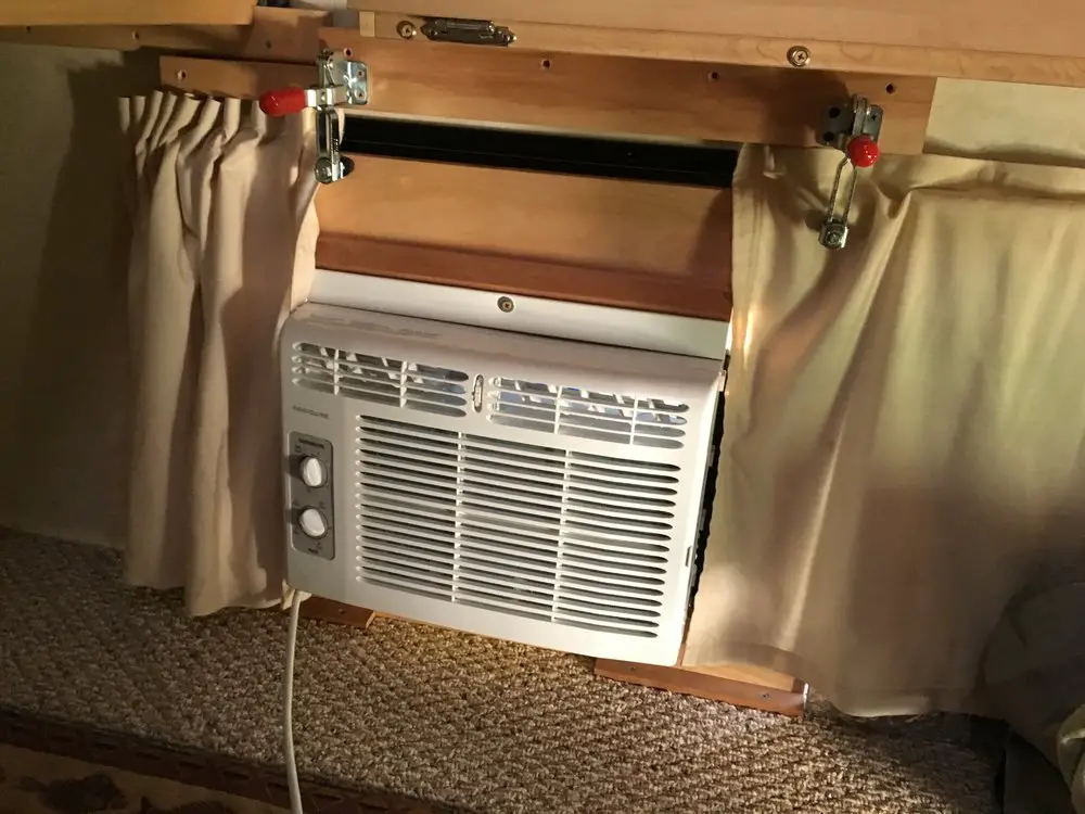

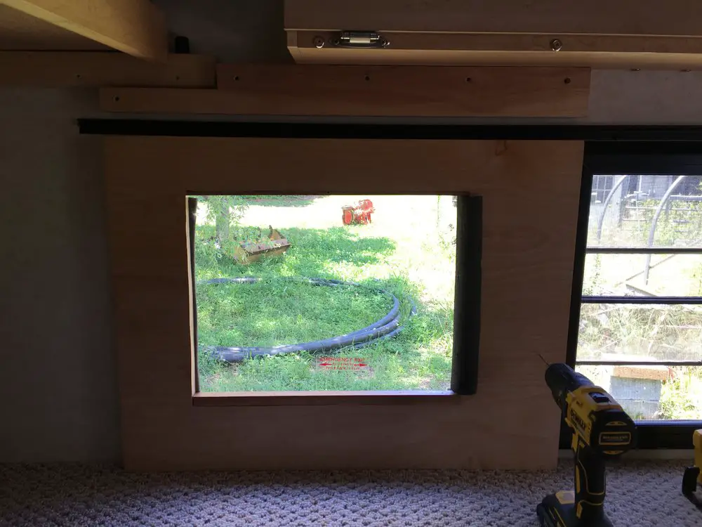

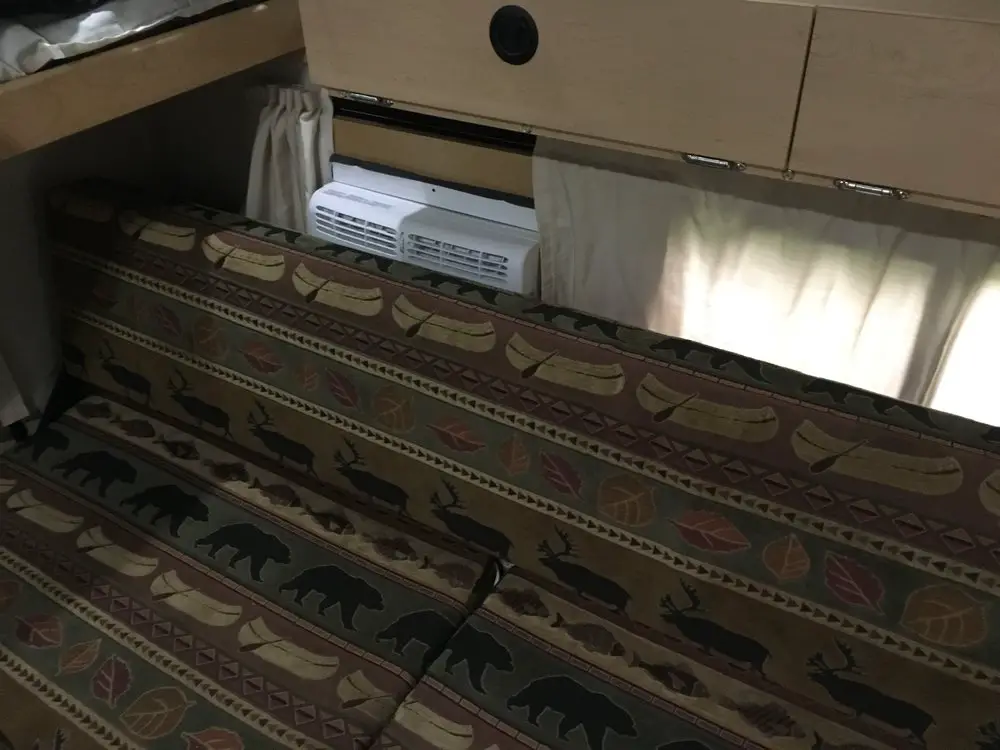

Had to do a few more mods to it to get it level for proper drainage and more secure so someone can't just push it through. Dad and I installed a header above the curtain track and attached these red handled clamps to hold the top of the board in place. We also added two strips along the bottom so now the bottom is secure. I need to insulate the edges but for the most part, it's done. Still wishing the cord were longer...Something else I figured out is when I'm up in the cab-over bunk, I can use the back side of the roll over couch to direct the colder air upwards. Honda SXS, meet dad.

I guess you could say I'm getting old and need my comforts of home. That being said I've gone from sleeping in the back of my truck under the topper to pulling my old trailer with the roof top tent to the FWC Hawk. For really warm nights in the RTT I actually had a 12volt fan running off the battery bank in the trailer's tongue box. For the past two years I've been wandering across America in the Hawk using the two Fantastic Fans to keep the air circulated and they've been great until you're in places like Phoenix Az at summer temps of 120* or today in Thompson Falls Montana where it reached 107*. Temperatures like these are where the fans make it feel like you're a Turkey in a convection oven. So even though I've not yet bought a generator to run one, my dad and I are fabricating a window unit perch to mount inside the Hawk in the hopes that some of the places I'll be staying will have hookups. I'll more than likely end up getting a generator but Do I need at least a 3000 watt to run a 5000 BTU AC ? I'm just not willing to spend $2000 on an Generator/AC system just yet. I am planning on mounting it in the emergency escape window. This will only be for when I am static in camp mode. I'm not gonna drive down the road with his sticking out of the window. Dad is an awesome Cabinet/furniture maker and is constructing it nice and so there are no bolt holes or any redneck mods. It will be very professionally done. This won't be permanent either, it'll be fully removable. The AC unit will be stored in the big tool box on the trailer when in transit. Later when I do get a gen set, I may store and run it in the trailer box with proper ventilation, then run a cord from the box to the Hawk. This way if I'm wheeling with a friend and need to leave my dog in the camper, the generator would stay running and secure in the box. My main question here is can I run a 5000 BTU AC on a Honda 2000 generator? Or, do I need to buy a larger more $$$ one?
Thanks
View attachment 48406 View attachment 48407 View attachment 48408 View attachment 48409
Well it has low voltage startup and when running it draws 4 amps and runs at 450watts so now you just need to know all your wattage for everything else you will be running then add 20% for start up voltage and that will tell you how big your generator needs to be.

If your running just your A/C unit there a 600 Watt generator will do after adding the 20% for startup.

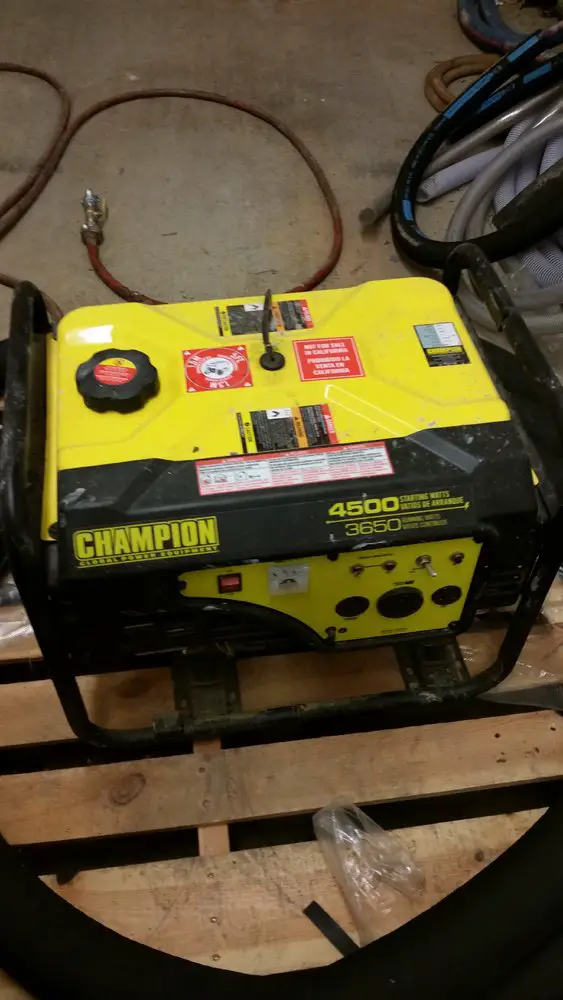

Anyone had much experience with the champion inverter gennys?
We have ran this one for over a year now at work just running power tools and crap. It hasn't gave any problems yet.
