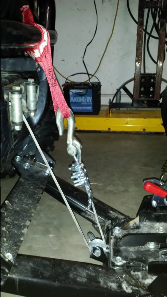

It does benefit. The pulley takes stress off the cable. The pulley is made to take the stress. Never had a problem. I use snatch blocks to winch out often. The pulley acts the same as a snatch block
No, it doesn't. The cable has no less tension in that configuration than if you hooked right to where the pulley is located. Using a snatch block in that type of orientation may work, but it doesn't provide benefit.

Perhaps the picture just makes the angles look odd, maybe the angle on the cable passing through the pulley points up more in real life, and that's not how it looks in the picture.
I take the statement above back. You can disagree all you want, my original assessment is correct.

My plow setup does not use the pully, it goes directly to the push tubes where you have the pully mounted, works great this way. Probably lifts twice as fast, which is fine with me.

You can disagree with physics all you want. I give up.
So it's a line guide.

I made my repair and really looked over the pulley, it doesn't look like there is any damage or extra space, so I finished plowing.
I do have an issue though. My less than perfect repair job, I used 3 U-bolts and they are taking away how much toom I have when raising the plow. I have to be careful or I will suck those U-bolts back into the pulley. I need to find a way to shorten the tow strap.

@Johnny just a thought to try....have your cable go over the top of that pully and hook back to the cross bar between the push tubes. One, that won't make the cable angle so drastic coming off the roller and two, it will give all the lift room you want. If need I can get picture of mine later and post it up. On my old kaw 4- wheeler warn actually had a cut out there for the winch hook.

I can understand the physics involved, I can't explain it, but I understand.
You can get a round sling (or flat web sling) in any length. double or triple wrap the sling until it is no slack. You might need a couple different lengths to try till you get the correct one. On another note, I can not tell for sure from your picture, but have you ever heard the phrase "never saddle a dead horse"? On a cable clamp, the round part should go over the part of the line that is short...the dead end. The saddle, goes over the live end (the part going to the winch) If you get it backwards the clamps will slip...
With the hook end of the cable going to the bumper, the cable is a two part line, and the winch has twice the strength it has in a straight pull.
if you hook the hook end to back to the push tubes it is NOT in a two part line, it is still only one, and there is no reduction of stress on the winch or line, but the plow will move twice as fast... Hope that all makes sense!!

To Hometeam, love that idea, I will try that.
To Up2it, lol, of course, I should have figured I would get it backwards! I looked and Im sort of in between.

Please keep in mind though, if you change the routing per Hometeam's suggestion, you have cut the mechanical advantage of the cable system in half, doubling the cable tension and lift speed exactly as Up2lt stated in his last paragraph. If that isn't a concern to you then there should be no problem.
Carney is right with his statement here. My thought is that pulley is so small it doesnt do a good job letting the cable run through it and that is really the stress point. It will speed up how it picks it up. Ideally if u had bigger pulley on bearings like shackle and double it back that would be the ideal setup. It was late when I wrote this and meant a snatch block not shackle...
