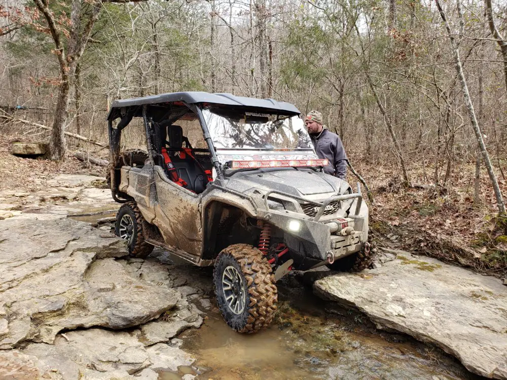

28x10x14's all 4 corners and spare on stock wheels. No problem
20190209 134020
Reactions: JTW and Landman
